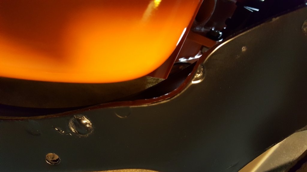

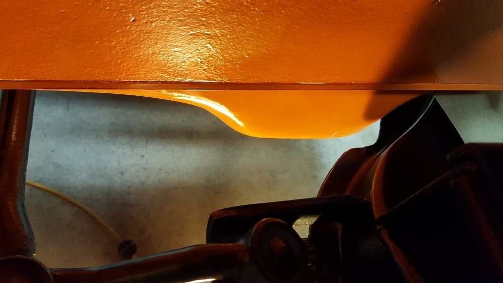

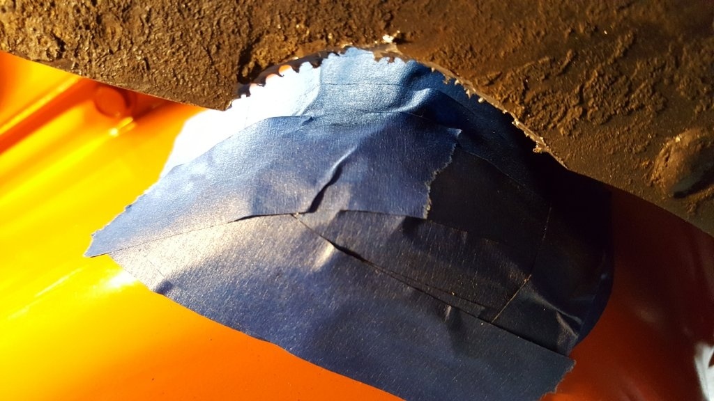

Here's what you can do for notching the K frame with the engine in the car.

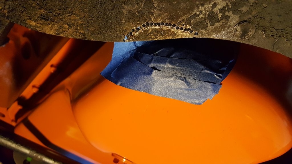

First I drilled a row of holes.

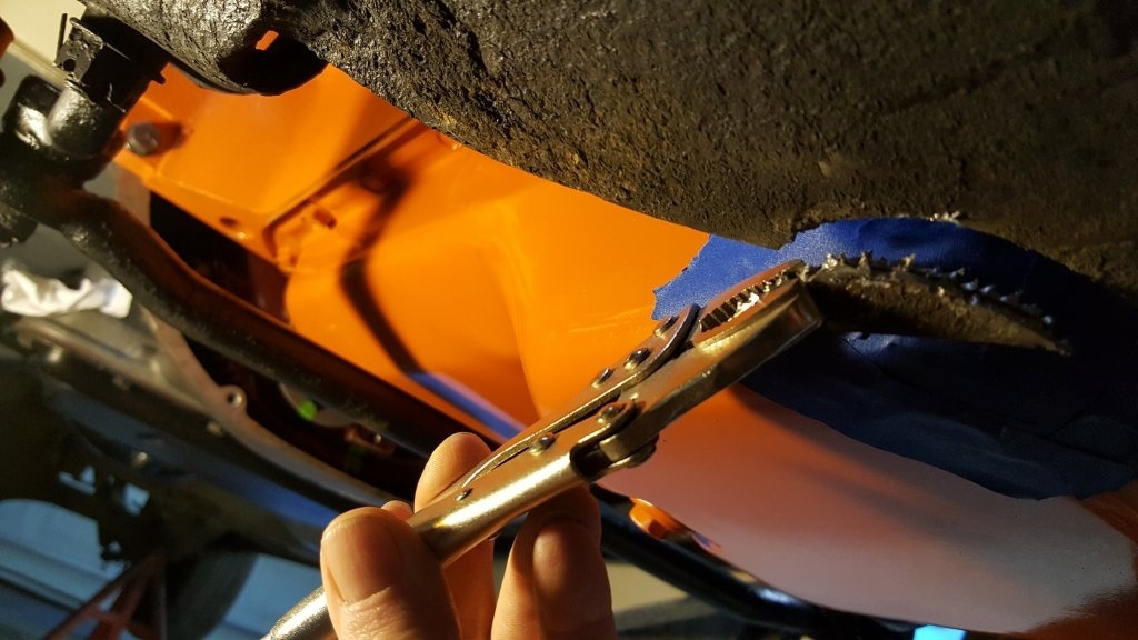

Then with a little help from a slicer, then vice grips, break out the section.

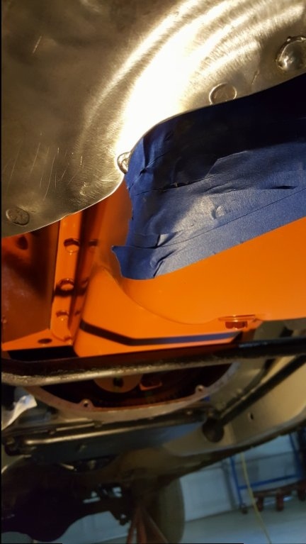

Then shape and smooth it out useing a couple of types of die grinders.
A couple of coats of paint.

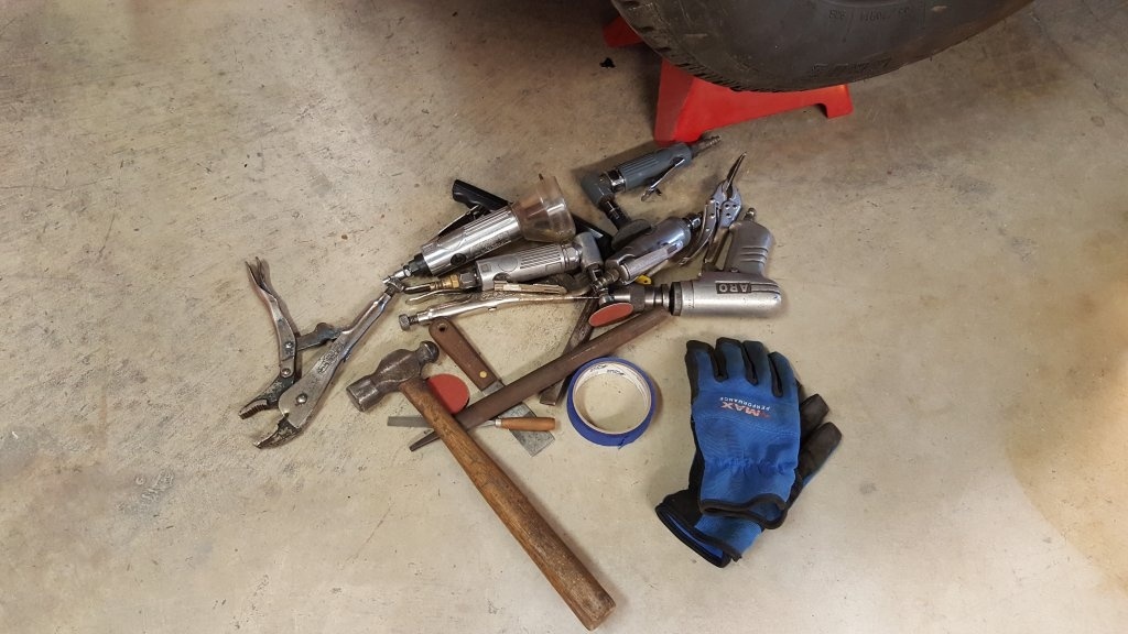

Here's the tools I ended up useing.
