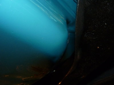

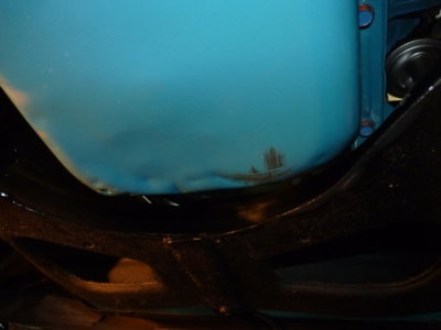

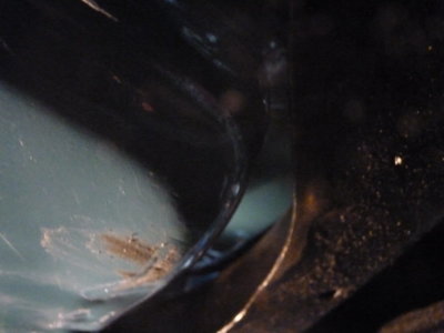

Can a 971 oil pan be used in a 1965 Belvedere for a big block swap? Thanks
i just put a 971 pan on my 64 belvedere,,,perfect fit
I would have to say that I'm surprised that it worked. I would have thought that the pan would be making contact with the K frame. I learned something...
no it cleare the crossmembe vey well,the 402 pan from a 68-70 b body are different and will make contact at the right corner
971 oïl pan in a 64 plymouth
