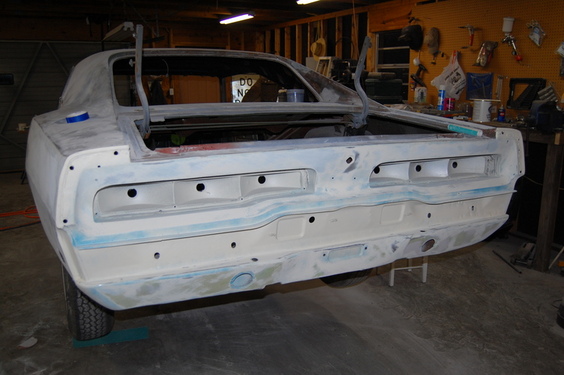

I want to try to finish this body myself. Right now Im at the filler work stage. (the car was pretty solid had to weld in little patches here and there). So heres and outline of what I plan on doing. so if any of you body guys have any suggestions of corrections please let me know. I have gathered info from forums like this and also bodyshop forums.
-Finish filler work as close as I can with 80 grit, then block over it with 180 to cut out 80 scratches
-Prime with a Polyester Primer (Slicksand or Featherfill or something similar)
-Guidecoat and block with 180 grit
-repeat if necessary
-Prime with 2k Urethane primer, guidecoat and block with 220
-Reprime with 2k, guidecoat and block with 400
-Prime with sealer
So does that sound like a good plan? Anything I missed or any suggestions appreciated.
Jason
Heres a couple of pics. The Blue you see in the rear pic is some spray can blue I used to guide coat the tailpanel after a coat of 2K.

Update, I was on vacation last week and got some work done. The shell was primed with epoxy (when the guy had it 2 years, he epoxied the shell and welded in the trunk floor) I stripped the hood and doors with chemical stripper, then prepped and sprayed them with epoxy. I got most of the filler work done on the left side of the car, the left quarter and rocker was the worst, they were solid but the quarter was covered in dents/dings, and the rocker, I found a previous repair, it had bondo, nearly and inch thick in places. I dug out all the old body filler, pulled the dent out and refilled. The doors were nice just had dings all along the body line, so I masked off and skimmed each side of the line with different color hardeners (so I could "see" my repair). Still gotta finish up the right quarter not as bad as left one but still needed attention. I went back to work today so it will probably be this weekend before I can work on it again. After I finish the filler work, my plan is to prime it with Slicksand and start blocking.
