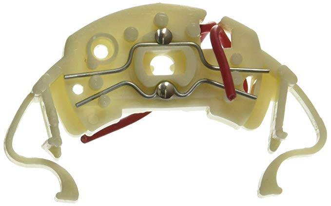

Picture shows what i have changed, but didnt fix....

Hmmm....the only aftermarket piece i used was the small top piece with 2 wires that rocks back and forth?
This time gonna replace whole assembly with new harness

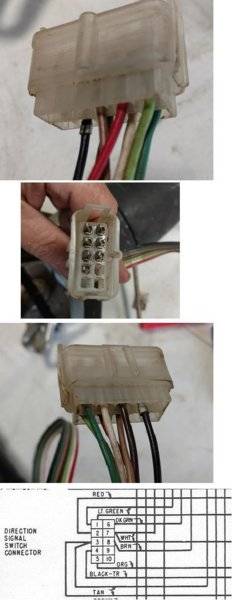

Best tool ever, your cell phone camera. My gallery is mostly full of things I'm going to take apart, even 3 pics of a steering column connector I did.
Send me those column harness pics!
Koosh, This is a 69 floor shift column (no orange lamp lead). These is the very reason I take pictures. If you notice the Black, partially inserted wire, it is in the wrong position. It belongs in the opposite empty position. I probably started and decided to take a picture before I went any further.
