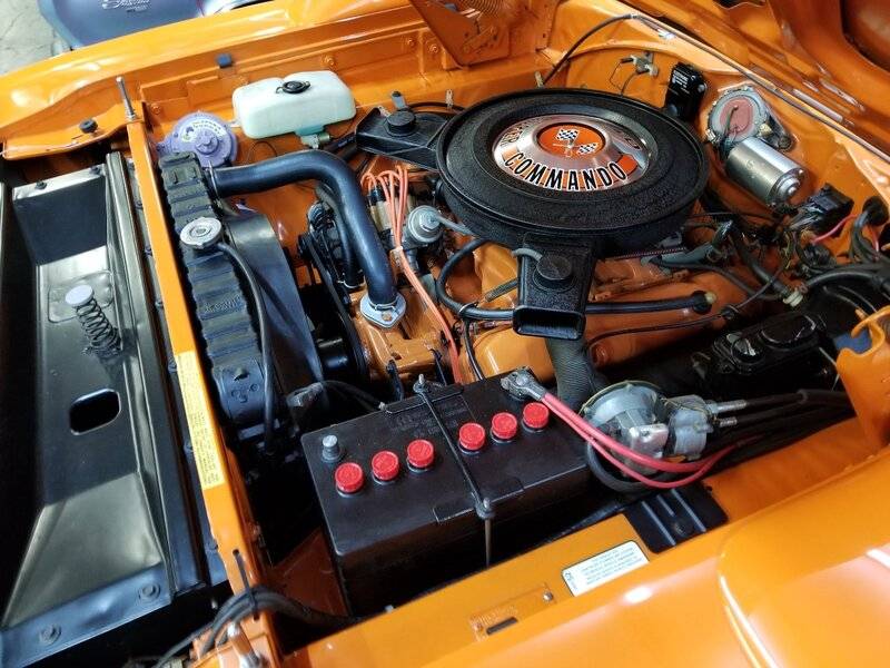

I have a 1970 rr clone with a 440. Which air cleaner would a runner have come with on a 440 “without” an air grabber?
thanks!

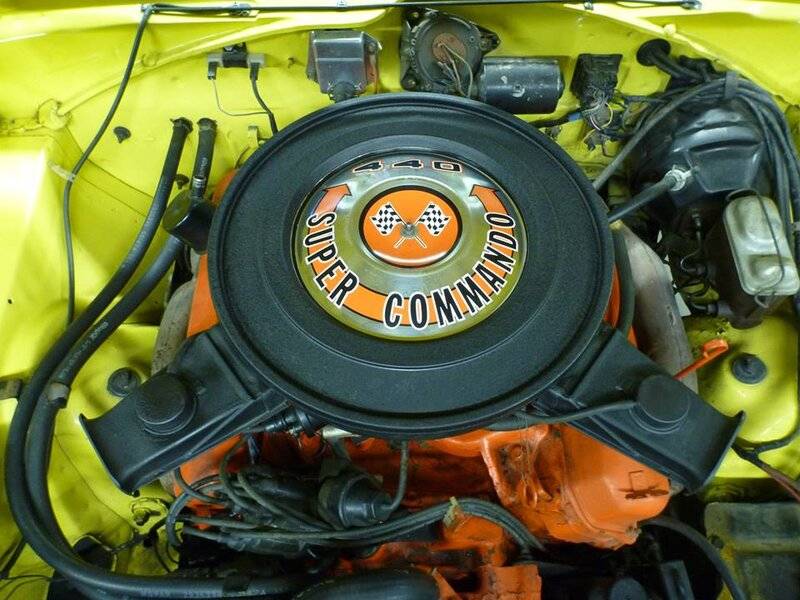

A dual snorkel I believe with the squared off ends and vacuum doors.
This one here.
I think the 440 4bbl. was only available in the Superbird. The GTX would have had the 440 standard. The 383 Road Runner in ‘70 had the same air cleaner.

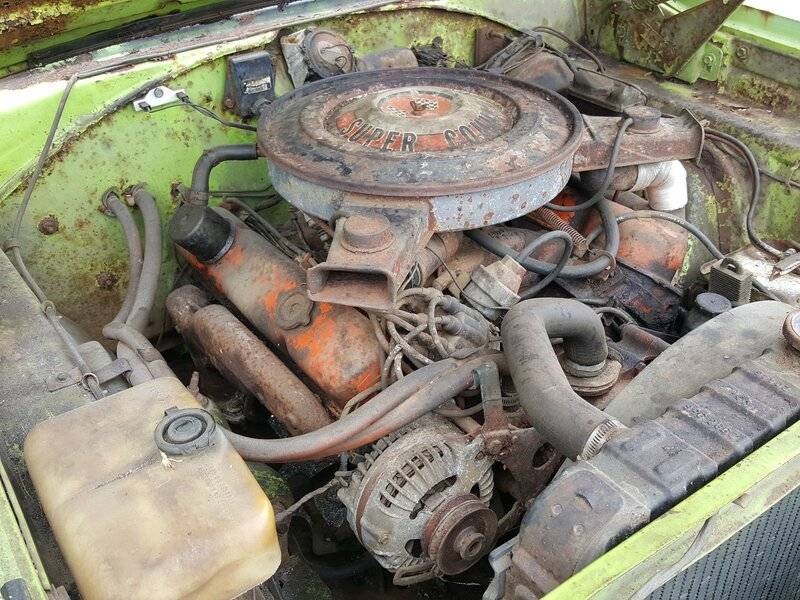

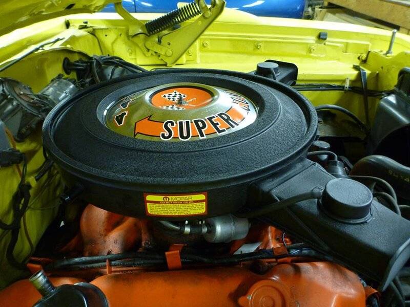

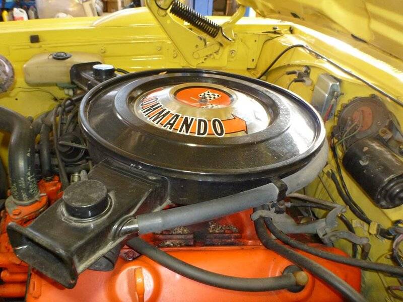

1970, note that both sides snorkel reinforcing gussets are a triangle. After that one side was triangle the other a rounded shape. 1971 has the breather hose coming off the drivers side and wraps around as shown in the third picture.
1971 cleaner..
