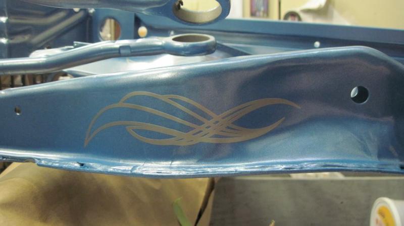

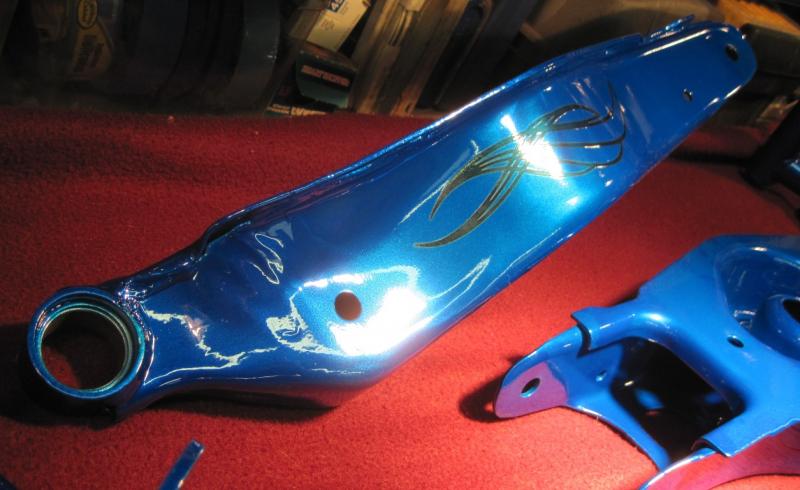

Absolutely! "Clear Vision" is a very popular addition around here not just for extra shine but to allow silver, gold and chrome-looking powders to maintain UV stability.
Though regular paper stickers won't work to my knowledge, vinyl decals can be embedded right into (or on top of) any powder for a custom look. Here's a 2005 Magnum control arm before, during and after for you tallhair ...
When it's done right, powder coating is only a few mils thick, about the same as a paint job. It just lasts longer.
