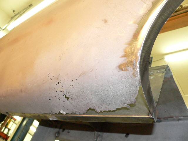

On a diet
Mine came with the Detroit acid dip.
Doug
So you are a lightweight also how cool is that.
