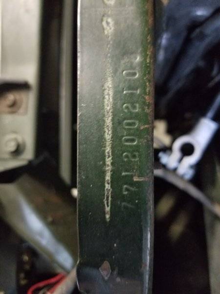

I never doubt some people....so I didn’t doubt you at all..I was looking forward to something different...Ma Mopar was never perfect and plants had variations...I stand corrected, they are SO numbers on the core support. View attachment 777847 View attachment 777848 View attachment 777849
Thanks for sticking to your guns and making me verify my statements.
The last time I verified numbers on most of my cars was at purchase. I guess I'm getting forgetful in my old age. That GTX, I have had for about 15-18 years. My newest 67 I have had more than 7-9 years. Upon taking the pictures this morning I realized that the VIN # is on the certa card and door jam, and the SO # is on the core support, fender tag, and the inside of the LR bumper bracket.never doubt some people....so I didn’t doubt you at all..I was looking forward to something different...Ma Mopar was never perfect and plants had variations...

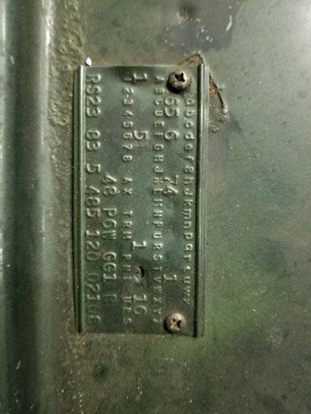

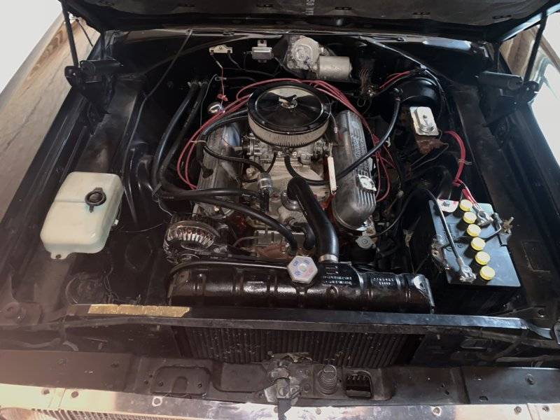

View attachment 777980 It is and F code 318 and the SO Number is on the radiator support in 66-67View attachment 777980View attachment 777981View attachment 777980View attachment 777981View attachment 777982
