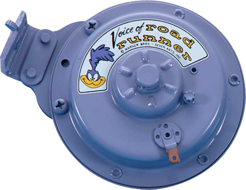

The high and low tone horns look like these.

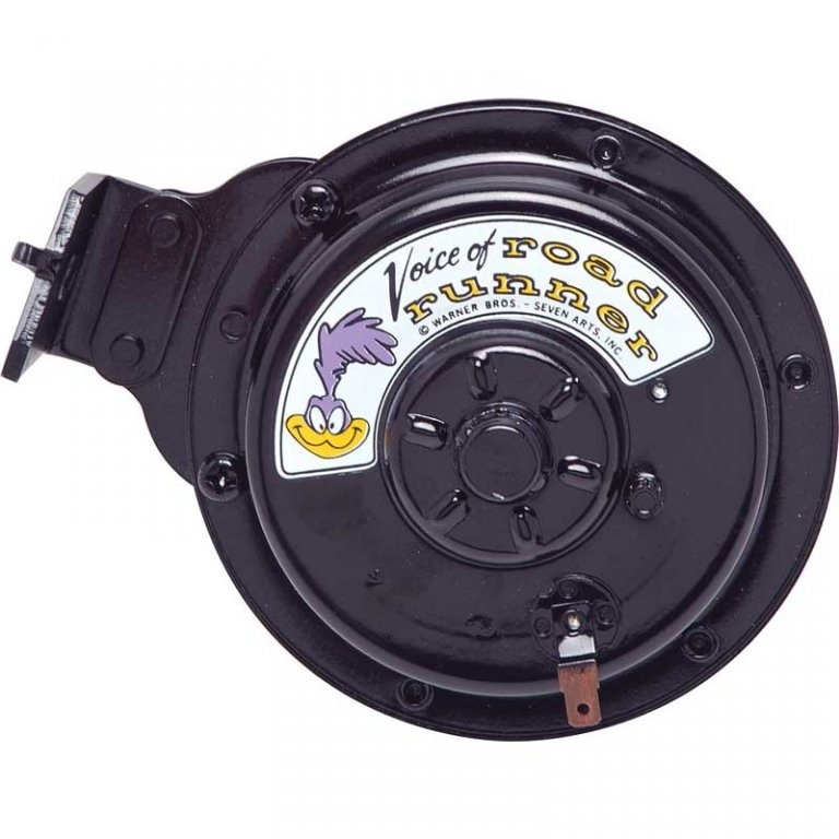

Roadrunner horns look like these either purple or black depending on year.
If its original horn, most likely the sticker has worn off. Also, I believe the 71/72 have a longer bracket, and maybe the 70 as well, but not 100% sure which years have that bracket. 73/74 are the short bracket shown in the pics.

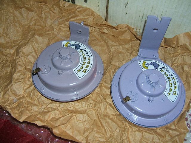

the horn on the right is the correct horn for your 1971 road runner
nos horns are in pic below
notice that they are even a shade off in color..
