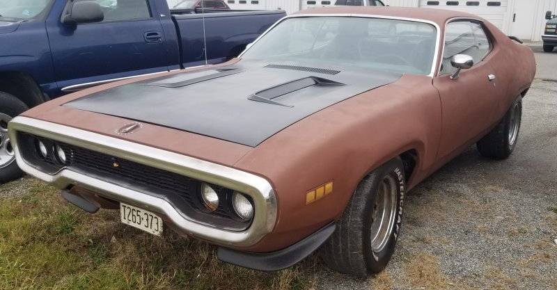

Hello all. I'm a 30yr auto body tech and constantly building project cars. This is my latest endeavor. 1971 B body, 440, 727, 8.75. PO asking $11k, i traded my '68 Merc Cougar for it. My intentions for this build are Roadrunner clone, Sassy Grass, factory stripe kit, factory interior with staggered Weld wheels and BFG tires.
After what I thought was a good visual inspection I drove this beast 5 miles from shop to home. Longest 5 miles in my life! A white knuckle, pants pooping experience to say the least...
I had front tires fighting each other to the point of constant squealing, jerking from left to right and braking resulted in teeth shaking tremors the likes of which only known by earthquake survivors.
So, without delay I will begin ordering a front suspension overhaul kit and a budget front power disc brake kit. Any advise/recommendations would be greatly appreciated.
Budget is key here. Im hoping to pull off entire build for around $10k doing all work myself (less front end alignment)
Welcome aboard! Looks to be in solid condition. Most likely your front end needs a little attention as you noted. Other than that, very nice overall. Good luck with your plans and future RR from another clone guy!

I like the 71-72 Plymouth body style and it seems you have a solid example. Painting a high impact color with the stripes needs a little jewelry to make it pop, at least for me. I suggest keeping the chrome front bumper and returning the rear bumper to chrome. Also maybe some chrome magnums with wheelwells full of tires. All in all it's your car, so make it yours.

Good score, looks like a solid project at least on the outside.

Your driving experience, suggests to me that the lower control arm bushings might be the culprit. You should change them regardless while you are overhauling.

Thank you. I have upper and lower polly bushings in my overhaul kit. Also polly sway bar and end link bushings.
