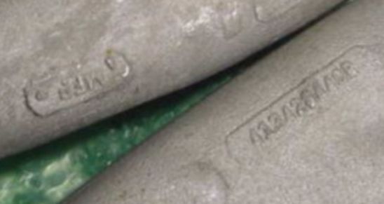

I can't find any information on line, but IF* the description is true, they are from the 60's. I can't make out the marking on them, but the petina and casting marks would almost support this.

It's a longshot....but it's interesting. They are either just cast in someone's basement, or they are ultra-rare, one-off pieces of racing history. LOL

The seller does not state they are from the 60's, in their other auction they clearly state that they are reproductions...made right here in the Motor City.
The part number seems to be '413426440P" (or B) which seems like a generic "fits all RB size" made up number.
