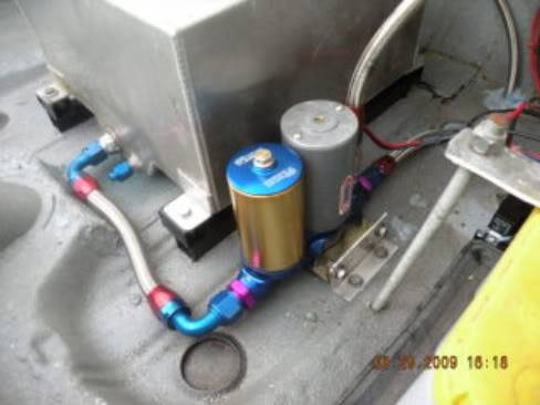

here's my setup,

here's my setup,
looks like a nice setup you got .... i havent had experience with the holley pumps, just hear-say ... i know a buddy of mine went through 3 in a row, all 3 of them siezed up in a relatively short period of time. now he runs a mallory with no problems ...
65-440, its the only way to go and i run a return system up front as well.
SSR, thats my plan for this winter. new pump, regulator and also run return line .... is that a matching regulator to the pump/filter ?
let me know if you want that setup, i'm a dealer for them. great pricing and free shipping.
its all product engineering products. they have a few different pumps to choose from. let me know.
