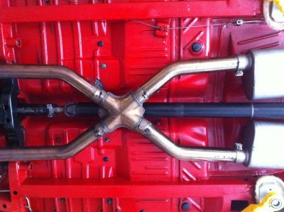

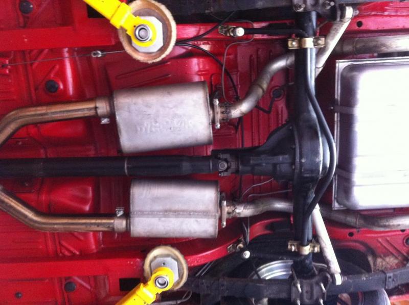

I'm in California. The cars I see out here are about 50/50 as far as having full undercoating. I never add it if the car didn't come with it. My Charger was a St Louis build, registered in Ca since new.
According to the restoration gurus, the under side was never fully painted. I say....So What? I like mine painted

I'm with The not so tall man. After removing undercoating from a lot of cars over the years only to find trapped moisture and rust in the seams etc, I really hate the crap. It adds weight to the car and sucks at sound proofing. In fact, I'd rather spray the underside with 90 weight oil than undercoat it. Kern Dog, that's the way I like the bottom of my cars to look.

All the more reason to use bedliner, you cannot chip it no matter what you do............ it's rubber and it's on there! Living where I do painting the bottom of a car is not even an option and I hate getting covered in oil every time I crawl under my car.
