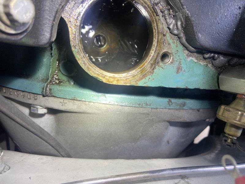

I went home during lunch and checked the engine vacuum and also tried to show the timing mark jumping around (not very successful). It looks like it jumps about 5 degrees to the before side then jumps back to the zero mark. The second video is of what i perceive as play in the rotor/gear slot, but maybe this is normal. The images included is after I removed the distributor to see if the slot in the intermediate shaft was worn.
The jumping of the timing mark does not concern me that much as the engine is running great and maybe it is the harmonic balancer skipping. I can replace that later. What does bother me is the timing reverting back to 10-12 after I increased it to 18.

Attached are two videos of the findings after removing the intermediate shaft and bushing. Both the bronze bushing and slot in intermediate shaft gear had some wear on them. I have not checked to see if this solved the timing mark jumping around. However when driving today on the highway it seemed like a much smother drive and at 65 mph I was only at about 2000 rpm. Where as before I had to push it to get to this speed.
