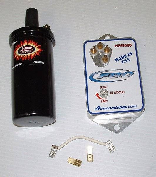

The one I have did work and certainly may be reliable but beware....it made my tachometer needle bounce a lot. I tried soldering in a diode but it didn't help. I have an aftermarket Dakota Digital instrument cluster with all digital components. Maybe a different tachometer would be okay with the FBO setup? I could try the FBO box in my other car and report back. Jigsaw has a stock type setup.These days, if you insist on the Mopar-style electronic ignition the unit from FBO can't be beat....and it has an adjustable rev limiter which is nice for those of us with solid cams and good valvetrains!
That said, I keep an old known-good MP chrome ECU in the trunk just in case![]()
