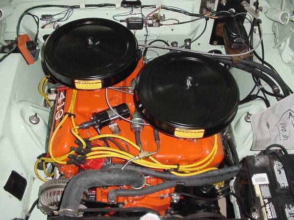

I have seen some of our B-Body friends with (Hemi) (Wedge) Orange Painted Valve Covers, Intake Manifold, Valley Covers.
I presume it is powder coat ?
Please let us all know.
I think it is really, really cool
Thanks !

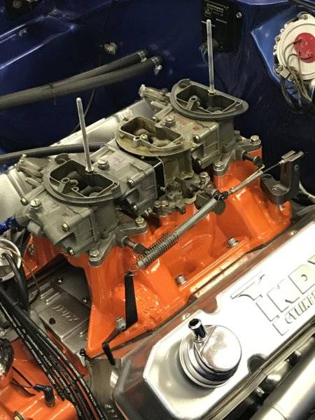

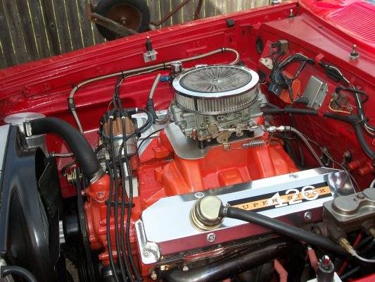

Mine is painted. Standard single stage urethane car body paint. Not only that but there's body filler in the valve covers a they were not very flat. The "INDY" logo on the heads are filled also. I experimented years ago trying to make a factory cross ram look smooth. Tried high build primer, it cracked. Then I tried body filler. That was the trick. The intake is still in use on my friends Max Wedge Fury over 20 years later with the same paint. The race car motor paint is now 5 years old. Still looks the same. Here's a pic of the motor in my wife's car painted 15 years ago. Powder coat works as well. My sons car has powder coating intake and valve covers. Paint has more gloss.

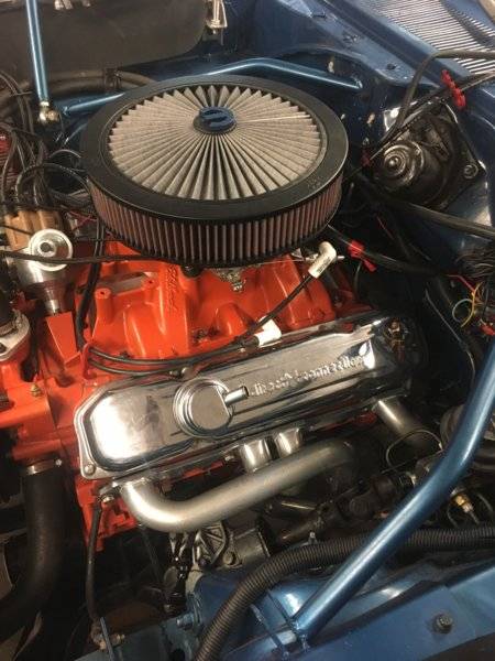

I sold this car a while back. Everything orange on this motor was powder coated. I did not have the hedders coated. After five or six years the powder coating was still holding up very well.

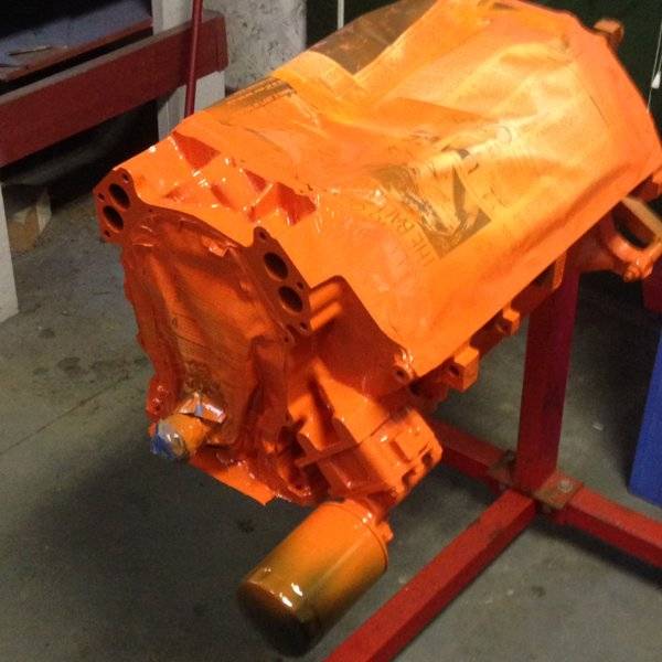

Everything orange (including aluminum heads and intake) is all painted with VHT self etch prime then Duplicor HEMI Orange engine paint.

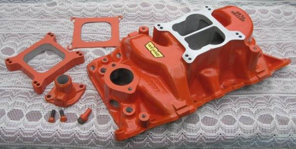

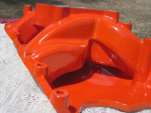

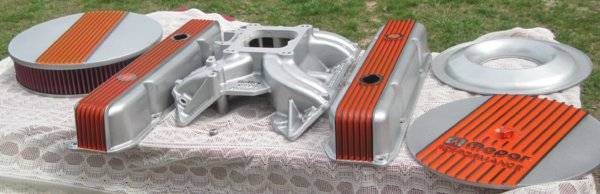

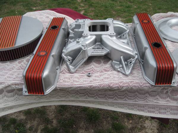

Powder coating is available in thousands of colors, finishes and textures now. My favorite replica for Hemi Orange is an identical match to the DupliColor paint version. Now in business for over ten years, even my earliest pre-pro work "looks as great as the day it got here" and has held up fine on the street, strip and show circuit according to the fine customers who share their feedback.
There are a couple versions of clear, both shiny and matte, which do not yellow or discolor over time unlike the commercial spray versions. Most shiny powders do not need to be cleared separately (unless you prefer a matte finish instead), but all silvers, golds, and even some reds are not UV stable on their own so they require it. [Talk to me if you're interested in a chrome replica powder -- it needs its own paragraph lol.]
I could sit here all day and tell you how awesome it is but pictures and feedback tell a better story. I'm not exactly the World's Best Salesperson. LOL

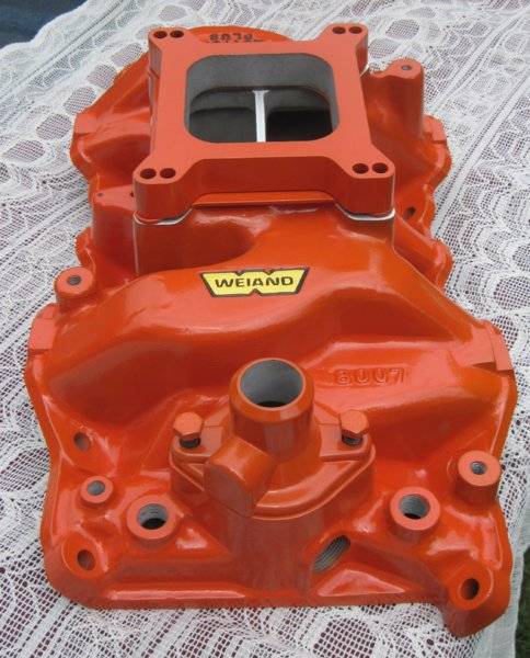

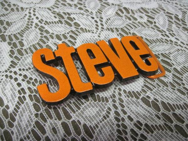

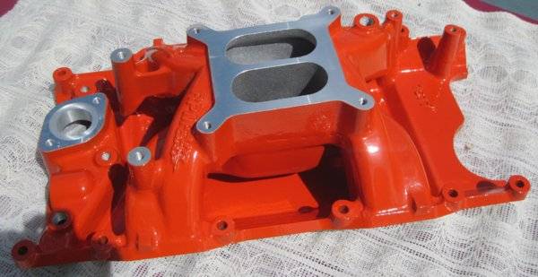

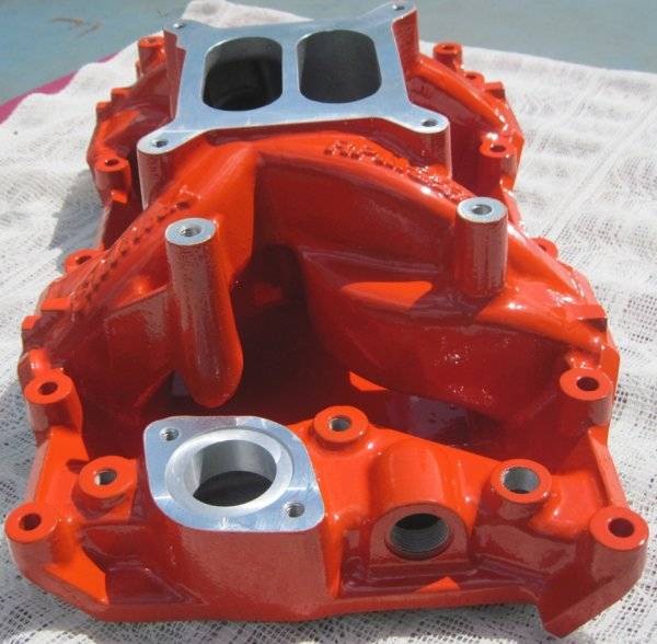

Here's a few samples involving my Hemi Orange with dozens more on my website and right here on FBBO in my Garage. The two-color belt buckle shown below is probably my closest match to that engine you first posted @Mike Gaines ... it more resembles the late model Header Orange to me but I may be mistaken -- monitor settings can change appearance.
If you like what you see, don't forget that FBBO Members always get a discount! Military (active / retired / Veterans) and Law Enforcement get a bigger one. Hit me up with some pics of your parts if you'd like a personalized quote; I bill at $35 an hour across the board before your discount is applied. Intakes average $150-$300 and my custom valve covers are all over the map depending on metal condition and how many colors you want. You dream it up and I'll make it happen.

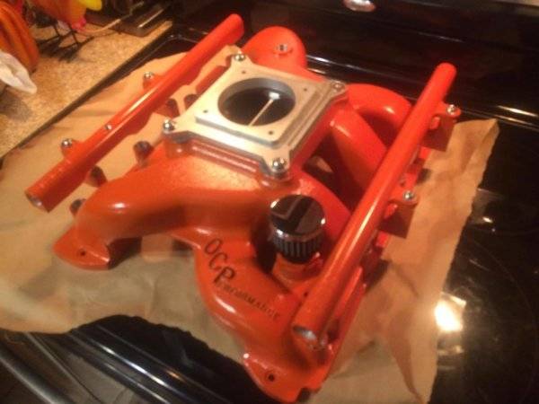

Customer photo by the owner of OC Performance for his personal new Hemi ...
