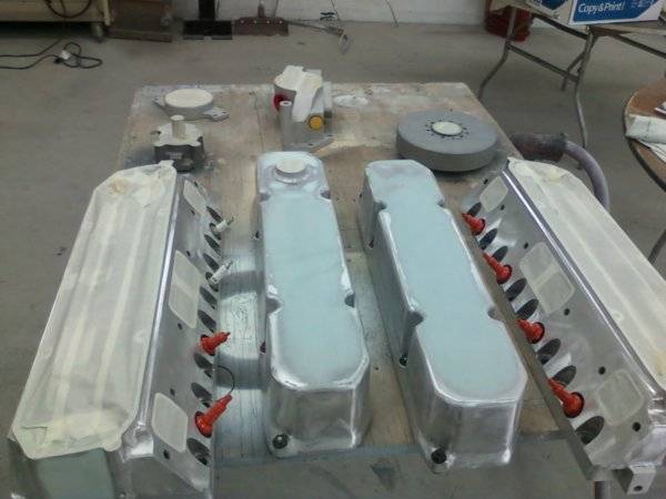

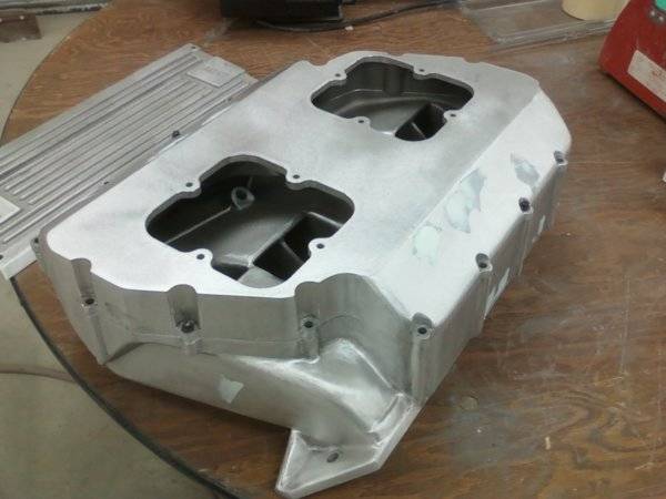

View attachment 558998 View attachment 558997
I have the eastwood kit, and I have parts that i did over 10 years ago.still look great. I'v done intakes, valve covers, oil pans, brackets, cast valley pan, air cleaners. All hold up really well. Like paint, prep is critical. If you don't want to invest all the money for equipment , and time, it's best to send it to a pro.
My intake is powder coated, holds up fine. Only issue is it’ll come off around the bolts that hold the intake on if you put in on and off a few times. Valve covers are powder coated also. I did both with the Eastwood kit myself.
My cross ram is also powder coated, had it done professionally over 10 years ago now.
