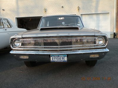

Listen here you evil rich bastard! LOL... I want my fair share! I'm going to write Uncle Baaarock and tell him I want your 65 A990 Coronet because you have more than I do. LMAO
I wonder if I'll have to pay a gas guzzler tax on it?
You know I'm only evil when I'm driving in NYC. You've heard me 1st hand!!

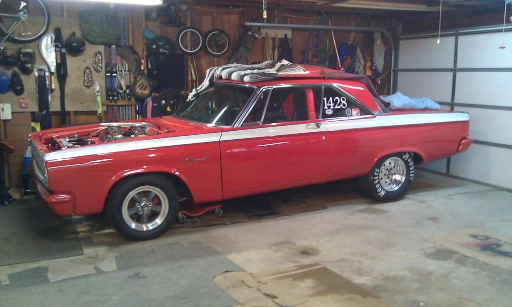

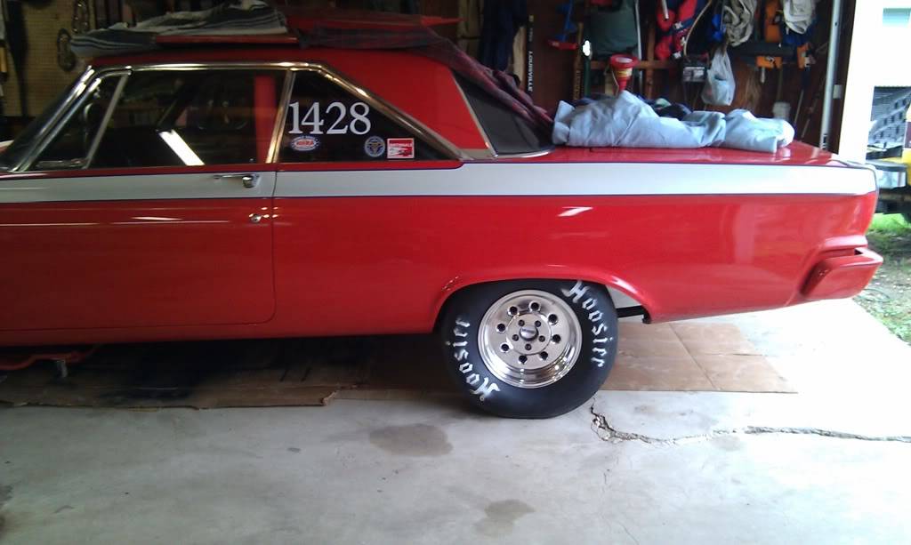

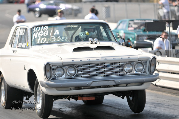

Well I got my rims/slicks on the car. I am glad I didn't go with the 29.5's because these FILL the wheel wells. You guys were right, the white letters look good.
One of these days I will get a picture of the car with the hood on it.
Are those draglites on the back?
get the red plugs to put in the holes your not using on the rear, next you got to get the matching fronts and ditch the torque thrusts. They are too heavy for racing. great for cruising.
I told you the 29's are a perfect fit.i think the white letters like awesome on your car.
Its just a good lookin car!!!!The car has a nice stance,and I have to admit the older dodges do look good with the white lettering.It gives it a nostalgia look I guess.:icon_thumright:
Never doubted you on the size Chris after you told me that is what you had on yours. I had my doubts about the white letters but I must admit they look great. They go well with the white strip.
Funny you mentioned the Torq Thrust/Draglite swap because I just told my wife that I was thinking about selling the Torq Thrust and getting the Draglite fronts. Sucks because they are brand new. I will list them and see what happens.

Per your request Chris. I sold the Torq Thrust and ordered the matching fronts today. I weighed the Torq Thrust with the tires; 38.8lbs. I will weigh the others when I get them mounted to see how much weight I cut off the front end.
very good move. You'll notice your frontend probably will come up a little more believe it or not. Plus that torque thrust to different rear rim thing is old style and it really never did anything for me. I like the matching set all the way around.
That old school look was the poor mans way of racing.I think you'll like the all around draglite look.
Cant wait to see the new look.
