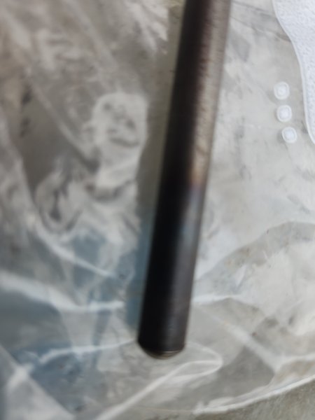

Stock 1970-318 This is my old one. All I can find says ball tip. Do they not make the originals anymore. I called Summit and Mancini Racing says their is Mopar Authentic restoration and theirs have the ball tip. Mine are 7.5 long. Could someone help me out on this please.

Not trying to make it that way , thats why I posted a pic of the original. Thank you for your help.

It is just a difference on how they were made. Most likely the OEM was designed and made a cheap as possible, The OEM looks to of had the end machined round and the tips hardened. You can see the heat discoloration. It was still considered a ball end. The replacements are a newer design which resembles a ball more. They may not even make your style anymore. 87 -88 was most likely the last of that style. I cant remember but its possible the newer looking one was used in production. So just order the new style and sleep well.
Originals were solid with
heat treated rounded ends.
New style are 3 piece hollow
with a ball welded to the
ends. Running the 3 piece
shouldn't be a problem
as long as you purchase a
good quality part.
good quality part.
