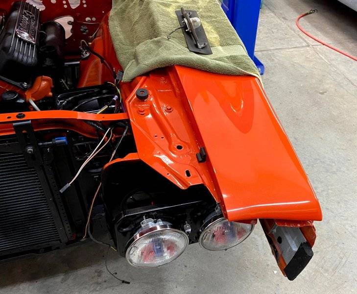

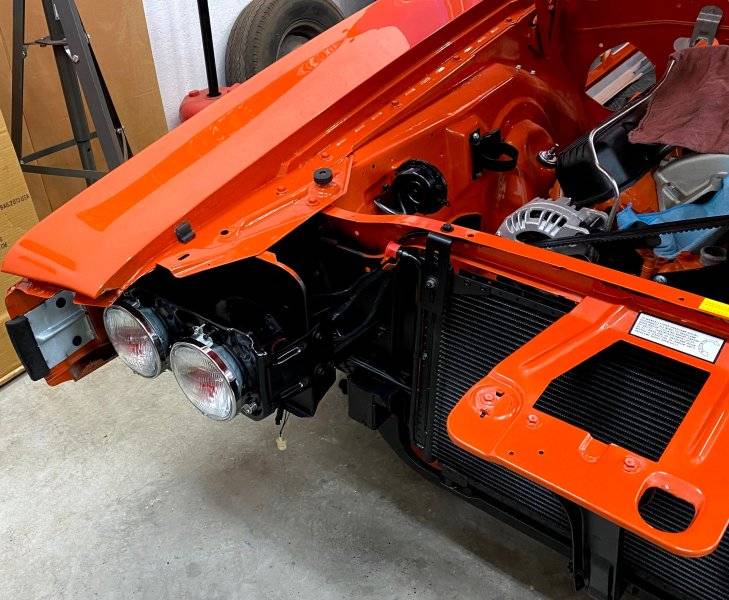

None on top of the cowl. Only the front of the core support visible through the grille. I used SEM Trim black on mine.
Pics
