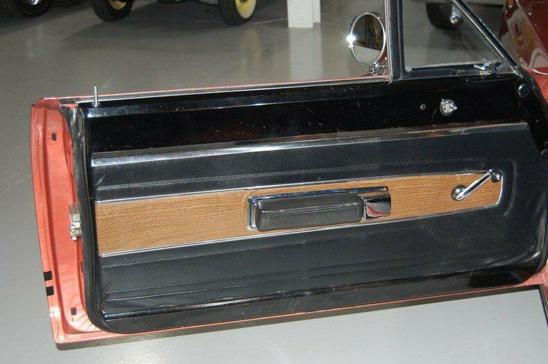

So what you are saying is all these things are incorrect or mismatched to date code on car???Here is photo of lock location,is this correct?
definetly not original

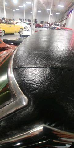

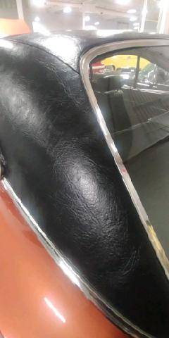

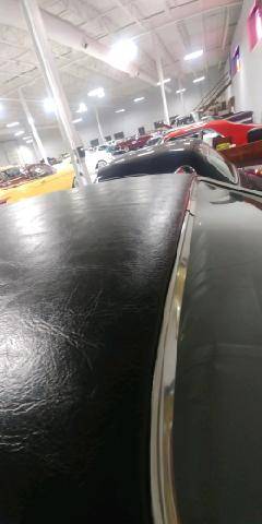

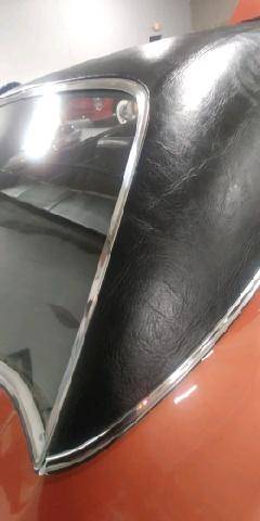

Any guesses on why in the world the top would get changed on a car like this?I guess to put back correct if you can would be expensive?Maybe the California sun was rough on it?
Maybe rust under the original they are famous for that or a tear, scratch, or stain.
Or PO just liked it better.
Not crazy expensive but others can comment on recent prices.
two options:
either rust or sun damage.
But if it was sun damage: The paint of the car wouldn't look like it does now
I think the car has been refurbished once. At least an outside respray and new v-roof.
It doesn't mean it is a bad car just not the survivor as them claim it to be.

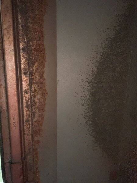

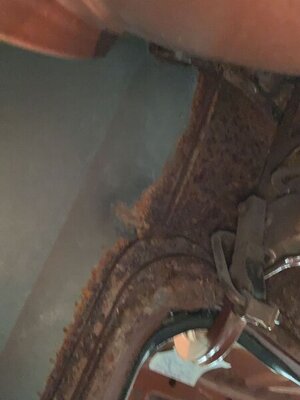

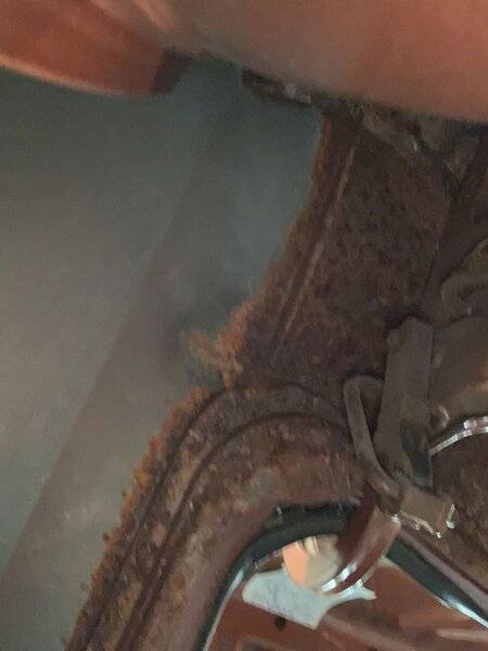

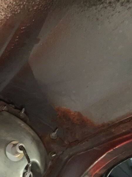

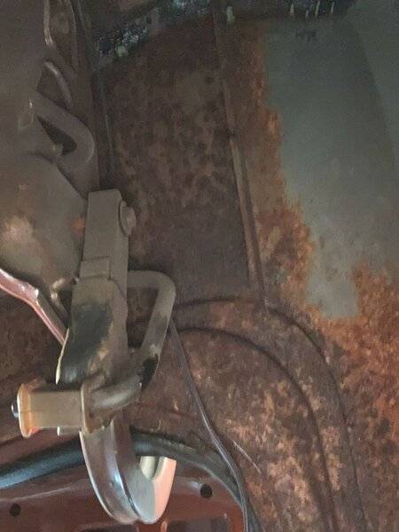

I would check the trunkfloor (without mat), lower rear quarters and trunk extensions in the bottom where they meet the quarterpanel.
Expect to pay about a grand to 1,300 to purchase the material and have it professionally installed.
If that car was sitting out in the California sun long enough for the top to be ruined then there's no way that the original paint could have survived. That car is most likely repainted, as has been previously suggested...
