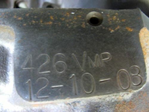

FOR SALE original Stage 3 426 engine, stored for decades, time capsule.
That block stamp is incorrect .....I would say a re stamp.Look at the bolt hole (chamfer)!

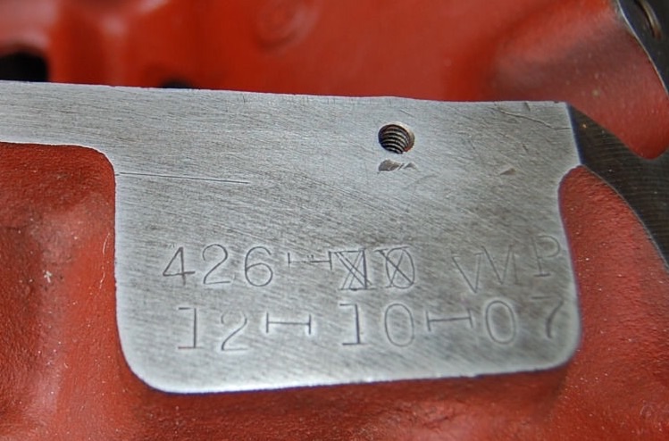

This one is a correct stamp..
And is the exact engine AFTER yours??
