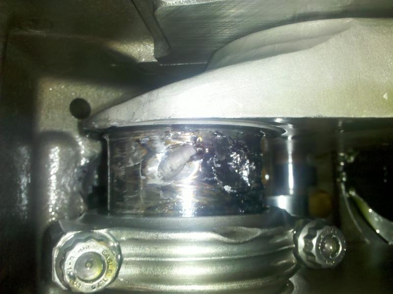

Well, I a couple of weeks ago I was getting ready to back the rockers off, but before I did I wanted to check the lash and leak the motor down. So I rolled the motor over to TCD and checked #2 int. it was fine, then I checked # 8 exh. (UHH OHH) I had over .050 lash. so I rolled it over and leaked it.... 0... now I knew it wasn't good. That's when I looked and found metal in the lifter valley.
to make a long story short we pulled the intake and found the cam had a chuck taken out of it but that was about it.
We then took the heads off, and everything looked fine.

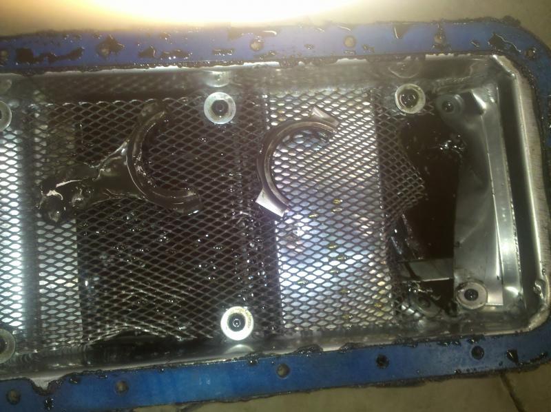

Well last night we pulled the short block out and put it on the stand. As I was pulling the pan off I noticed the convex dent in the oil pan... I knew we were in trouble. when I lifted the pan off it sounded like a box of rocks. and that's when I seen the carnage.

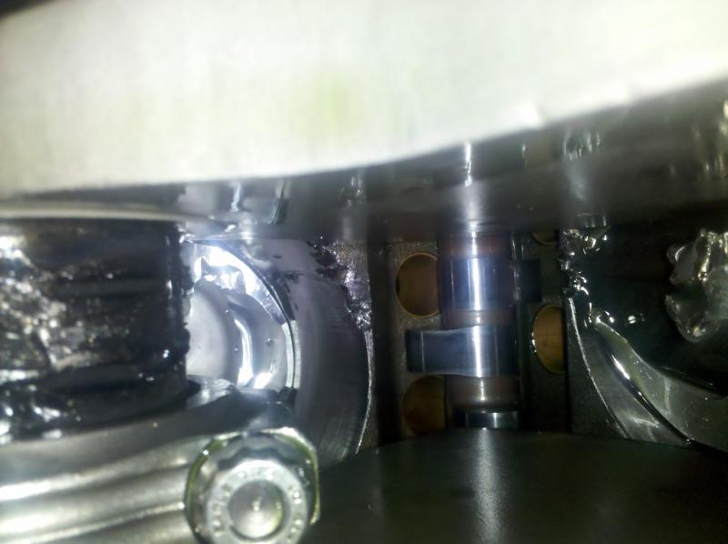

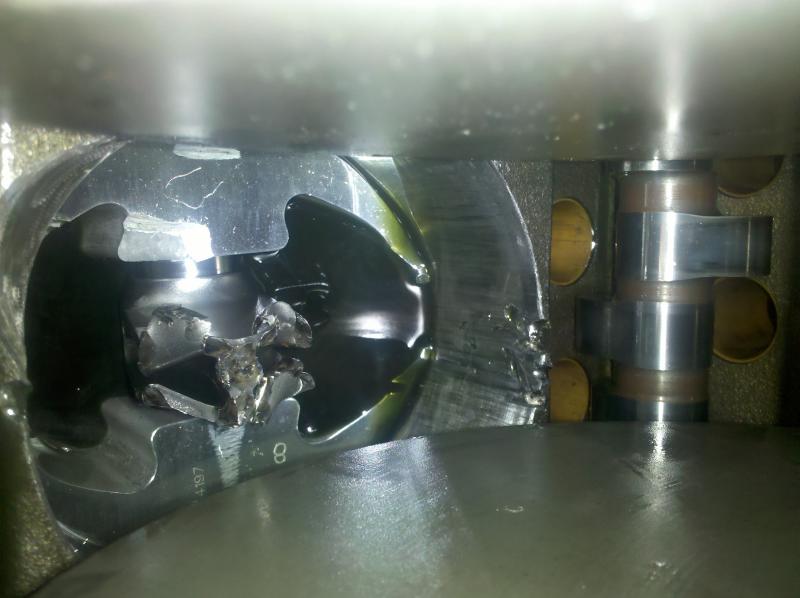

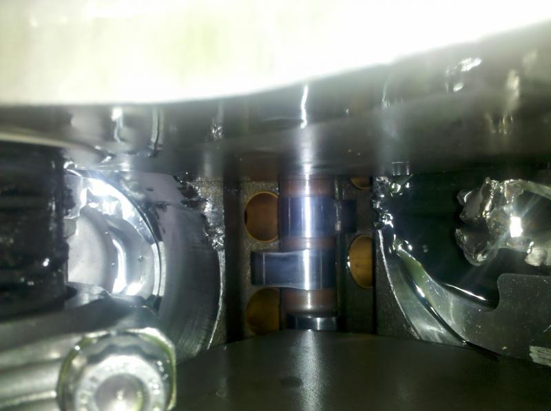

He broked #8 rod. It took the cam, crank, pistons and we have some niced gouges in the cylinder... at least that what I can see so far.
Hopefully the block can be fixed, we won't know that until we get the rods and crank out. The Crank, Rods and Pistons are junk. How the head didn't get hurt god only knows.

If there's no crackes in the cyls.you might get lucky and just grind the gouges smooth,other wise 2 sleeves will be in order! The head is probably the cheapest part not needing replaced! Can you say new short block?Good luck!

KD Belvedere, I'm so sorry to see & hear of that carnage, that looks pretty damn bad, hopefully the block is savable at-least, good the heads didn't get hurt, how I couldn't tell ya, wow maybe rod failure or rod-bolt failure, oil starvation, who knows what, started the whole thing ??, with that kind of total carnage/destruction, you would think you would have had some kind of sign, low or erratic oil pressure, knock, exhaust noise, metal in the oil, plug gaps closed up, or something, 1st before the big bang... Good luck, I wish you the best, it looks very expensive...

Budnick, Thanks; No there wasn't any indication according to dad. The car was running good at Norwalk and when he went to Indy on Friday he went 9.80 - 138.00, on Saturday 9.90 - 136.00 then on Sunday he went 9.81- 137.00, 9.84 - 137.00, he said on the last pass it was haulin the mail when he heard the pop.
I'm sure it wasn't starving for oil, it had 8.5 quarts in the pan + 1.5 in the accumulator. When we starting pulling the motor apart we checked the accumulator and it was empty which tells me that it did it's job and discharged the oil when the pressure dropped. When I drained the oil out I got about 9 quarts just out of draining the pan.
