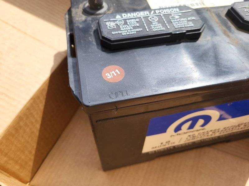

Out with the old, in with the new. Battery for the hotrod, old one only lasted 12 years dangit

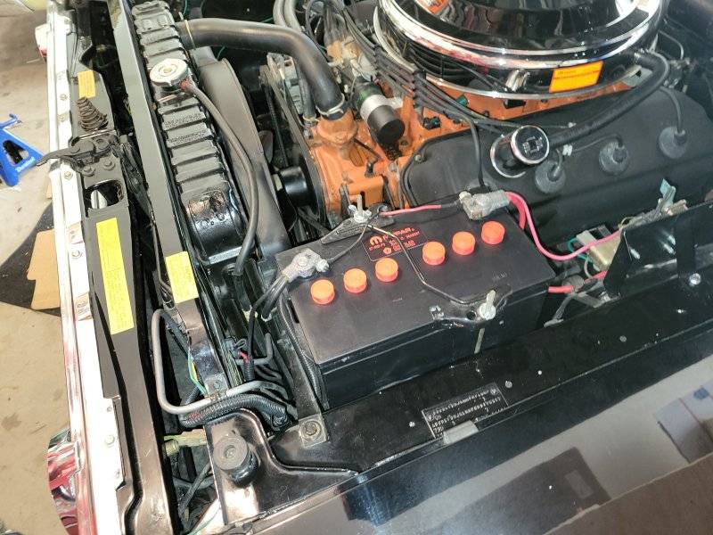

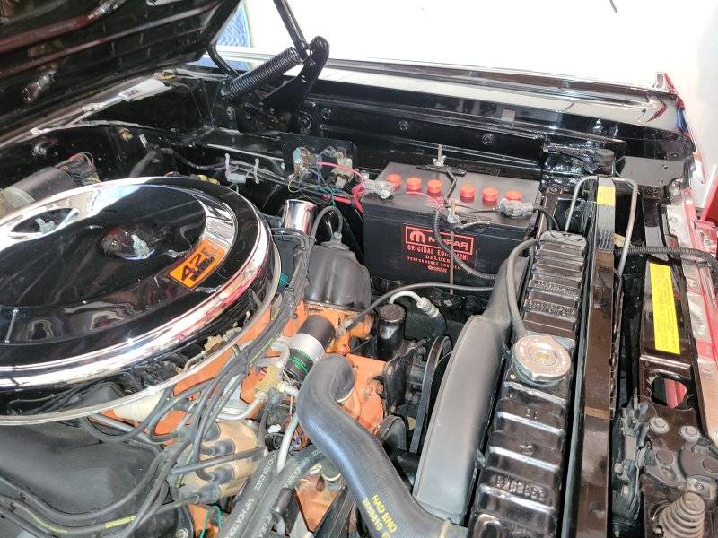

Finally pulled the old Mopar group 27 out today ( I think it was time )

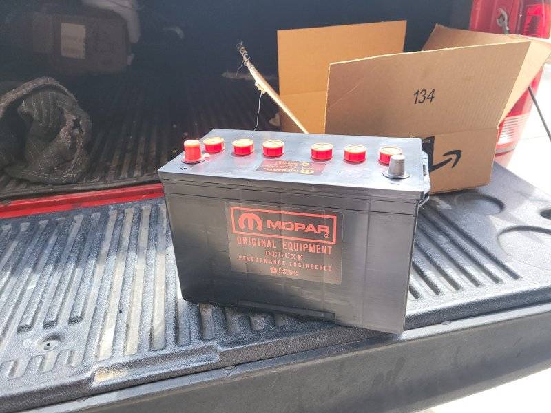

Bought a kit to convert one of the modern batteries for a more correct look, here > Mopar Battery S27M red (1966-74) Push in Caps kit | eBay
Using a Duralast from Autozone, mainly because it was the only one I could find that had the right shape and cap. Plus I get a pretty decent discount via work. A 3 year free replacement warranty doesn't hurt either.
https://www.autozone.com/batteries-...27-810-cca-27-dlg/115785_0_0?searchText=27dlg
I'll be honest, Its not going to fool any real purist at the OE level. But Im not buying a $300 - $350 repop battery ever again due to my experience in the past, Thanks, but no thanks. ( I have about half that in this one as shown )

Could be, We have a pretty good relationship with the local store. So maybe!!!!! maybe not. Either way I'll cross that bridge when / If I get to it. And besides, I peeled the sticker off and put it on the bottom, just in case.

An over the counter Mopar battery was near $300. A repop OE looking AGM battery was like $350
This Duralast was $154 my cost. And I think another $29 for the cap decal kit. And to be honest the case on the one I removed is 100% identical to the one I just installed, just different decal.
I think there are only 2 companies that actually make ALL the batteries out there. Johnson Controls, and cant remember the other. But think is Exide maybe???
So, no matter whom you buy it from, you're getting one or the other.
I went with costs and a reasonable appearance for the final product, just not 100% concerned will all out dead nuts OE please the purists correct. I want the look, and this is more than close enough for my liking. I drive my car, A lot,,,, weather permitting.

Ive only owned the Satellite right at 3 years. And its been on a tender for only maybe half that time.
Previous owner bought the battery new in 2011 per the sticker on it. But it was always on a tender during his ownership. Which helped it last Im sure.

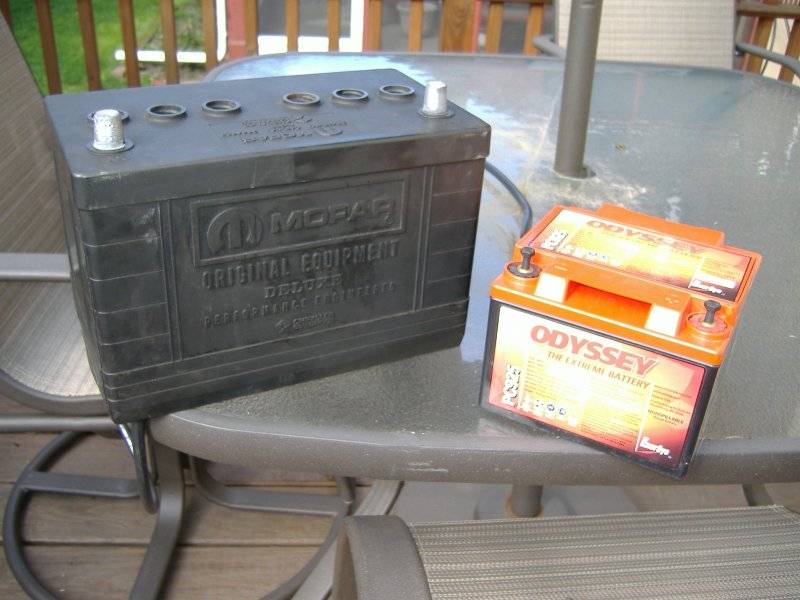

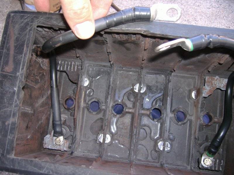

After my old lead-acid repro battery failed after about 3 years, I drained & gutted it. I put in one of these small Odyssey batteries in the case. The first one lasted over 12 years! Only changed it out because it was developing a slow crank in the warmer weather.
Saved about 15lbs in weight too!

Had my car had one of these batteries in it. I would have gone this direction. BUT it was just a modern Mopar over the counter battery. So I went the route it did.
It looks good, Not perfect. But I like it.
