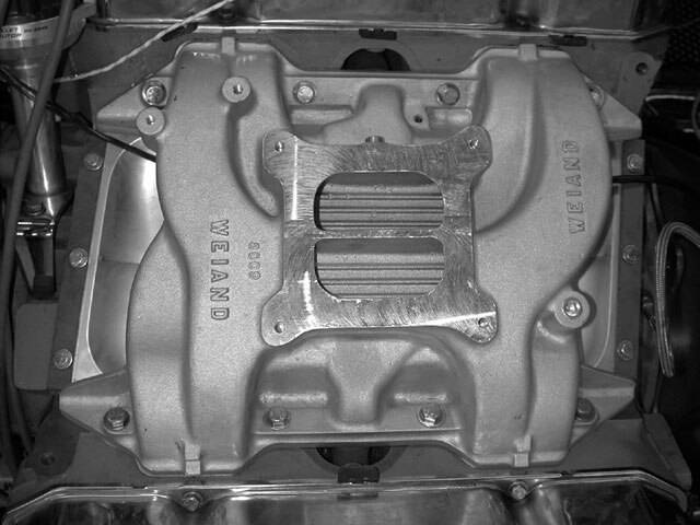

I bought a brand new in the box Weiand Action Plus and sold the used CH4B. Both were discussed as being close to stock cast iron manifold height.
I can find the Weiand for a 383 but not 440?

I have this for a 440. This should work
No one has mentioned there is an oval base for 383's & there is a oval base for 440... The 440 base is about 5/8" shorter.....
