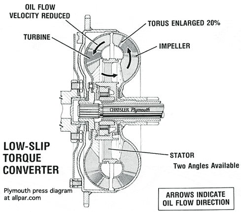

Lock up converter is what they're doing...
Chrysler had them in the {late 70's?} early/mid/late 80's,
sorry I don't use them to be specific still some older tranny shops have them,
know about them...
It's electronically controlled specific valve-body... No Computer needed
The valve body has a special bypass line & you need a lock up {low slip} converter....
a momentary switch can be used to activate & deactivate...

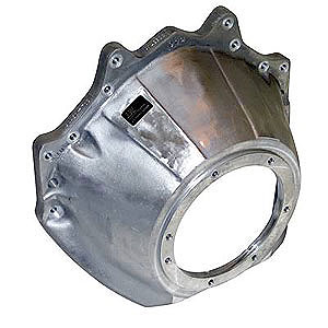

Or do a JW Performance BB Bell-housing on a newer SB O/D trans,
or an adapter, I know someone make one I just don't remember who...
still need the electronic interface thou...
