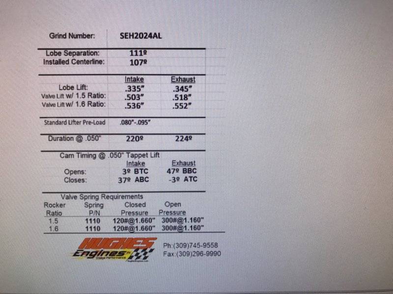

I'd like your opinions on this BUDGET build. Some parts are coming off the 340. Going in a heavy car ('73 SSP), cruiser, 904 with shift kit, 2,000 rpm stall converter, 3.55SG. 318/360 Performer intake, '69 HP exh manifolds, Summit 600cfm vacuum sec carb. Heads are '72 iron, valves opened to 2.02/1.60 valves, bowl ported.
- Hughes cam flat tappet hydraulic, 220/224 duration at .050

probably a good cam if the duration matches the torque curve- rpm range
you want
can't tell if it works with your compression and gears without the seat timing
hint
match it up with Howards lobe list- see if there is a fit on lift and .050 if so you can get the .006
