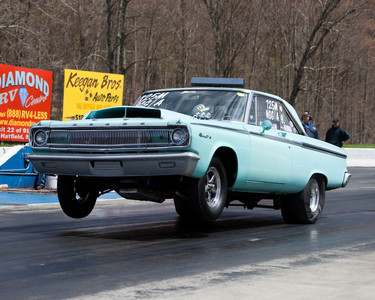

Santhuff front shocks for a early b body? My concern is that they only have 3.5" of front end travel.And I need full extention for my cars to work and transfer weight.
They look shorter than my Afco's and Strange double adjustable.I'm putting my AFCO'S on my 63 Plymouth and need a new set of shocks for my 65 blue dodge.
