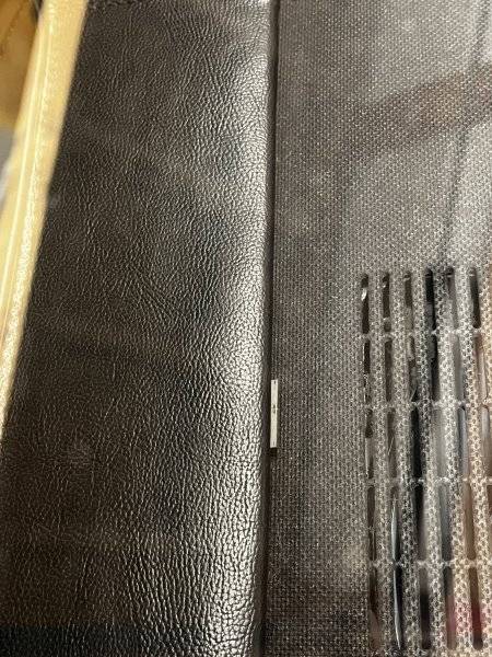

I ordered a nice new package tray from Classic Industries. The pre-punched holes for the two attachment clips are in the wrong spot which isn't a big deal.
My big question is do I need to install the tray before or after I install the rear glass?
