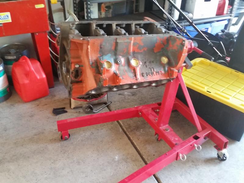

I started a thread about a crossram for this engine but I decided too expensive and not worth it for what I am hoping to achieve
This is the first engine I have ever built. I have no training aside from shop class in high school and my dad who used to be an auto shop teacher. I do however have a book that tells me how to do all this so here I go
I am told the block is from a 70 roadrunner, just got it back from shop bored .030 cam bearing and freeze plugs installed

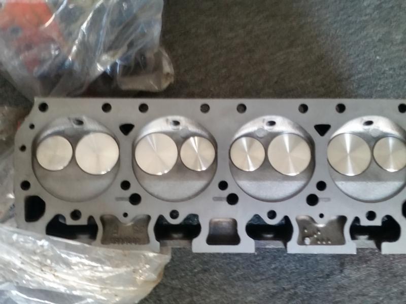

Heads are 452s with some work done to them, 87cc, I do not know what they flow

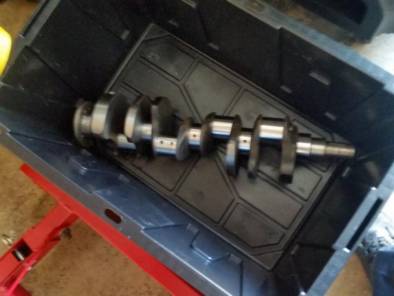

Crank is standard stroke and has been ground

The heads look nice, brand new valves! Do you know which one the used ?

No idea on the valves, shop called flow tech in Orange County did them but I never got the paperwork
