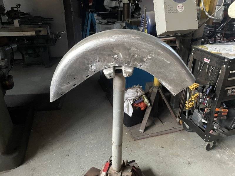

Recently I hit a deer doing 30 mph on my 03 Harley Ultra Classic. I am fine and have pretty much completely healed up but now I am trying to repair the bike. I am replacing the front fender and 1 lower fairing both of which I sourced from eBay. The lower fairing is very nice and will just require a scuff with 600 (I think) before priming and painting. The fender however had to be stripped completely because it had some light rust under the paint.

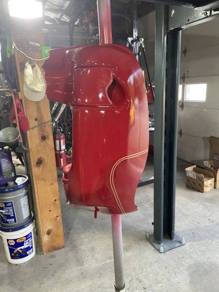

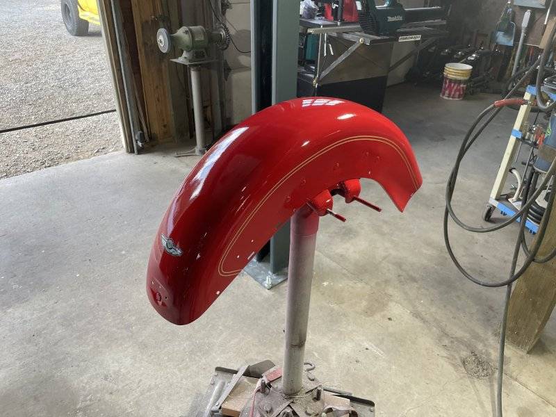

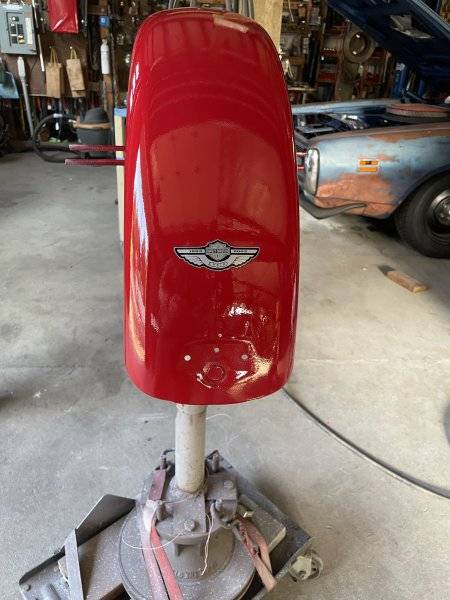

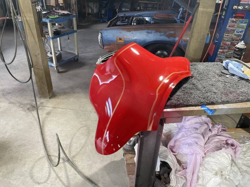

So for everyone who chimed in and provided some advice I want to thank you. I was able to get the bike components repainted. Its not perfect but its perfect enough.
