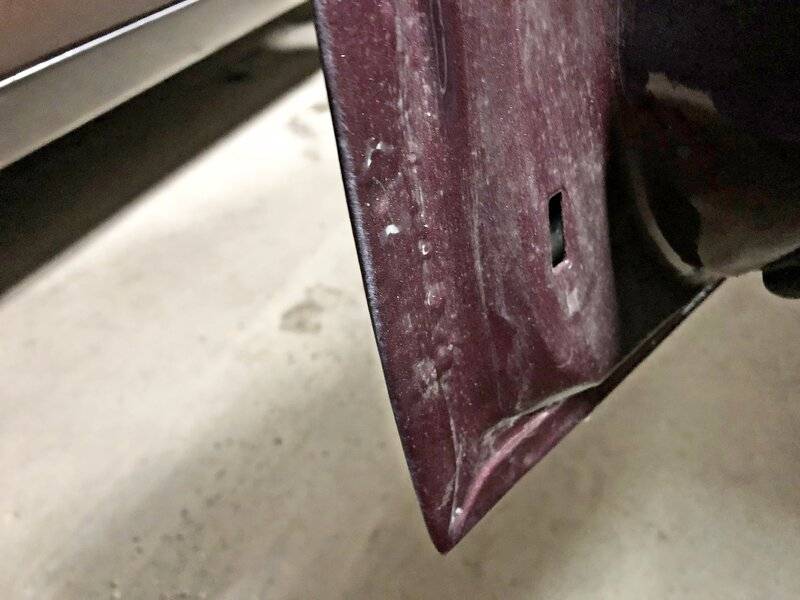

I am trying to beat the cold weather in Michigan and know that below 65 degrees is the cut off as far as spraying paint.
I want to use spray cans of Rustoleum sandable primer on the underside of the floor pans.
I will be using the urethane base coat paint over that primer on bare metal.
I am also using clear engine enamel over the base coat... because i want to have a thinner look.
The urethane clear has a thicker heavy look when dry. I believe it would be easier to use cans then a spray gun.

Yes sir..... I am only doing firewall and underneath for color purposes... where the engine and transmission will sit. I will be able then slide my elephant & 4spd this winter...
Next spring I will get the clear urethane coat for the top side for sure when i paint the car.
I will also do a compatibility test to confirm it will stick.
The clear urethane covers to much detail..... more than i would prefer + the clear is more resistant to heat near the engine.
Who ever painted my car last....... left it I do not like the inside crimped door skin edge filled way to heavy or thick.
Clear urethane has a time element or pot life.... where the base coat does not. I have used urethane before with great success.
