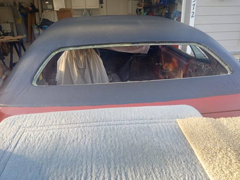

I had my paint guy shoot it and clear it. Then before the vinyl top I lightly scuffed it. Hope you have better luck than me finding a trim guy. Seems all the good one's are retired or dead.

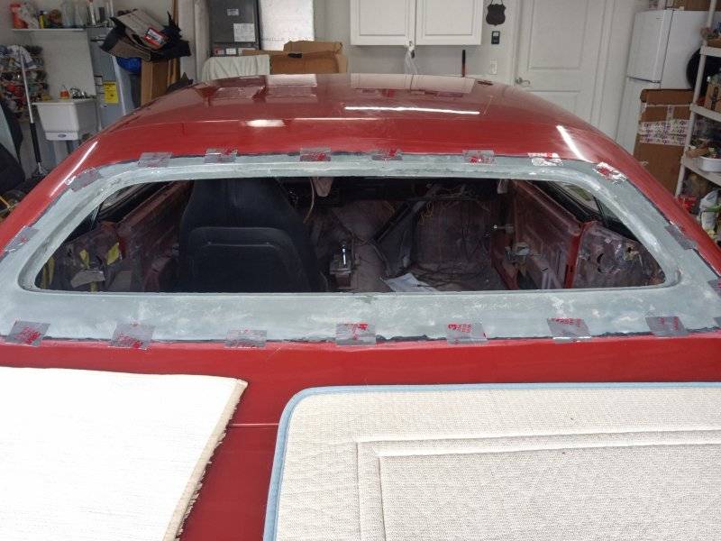

Looks familiar. Mine was unpleasant as well. Three tries by an experienced guy to get this one done. I like to use finish paint underneath over epoxy to make sure the metal is sealed as well as it can be, then scuff it before glue. Anything you do will be better than what the factory did.
