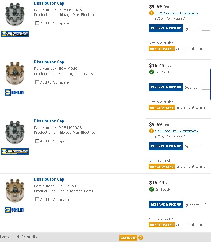

I was wondering about painting a cap too. I want a cap that is set up to have one bank of wires on one side of the cap and same with the other side, eliminating crossed wires at the cap for a tidy look. They are available but not in the tan color that I would prefer............................MO

Where do they sell those? And how much?
Mopar dizzy cap was the same almost forever. 2444507
NAPA has them, black or tan
