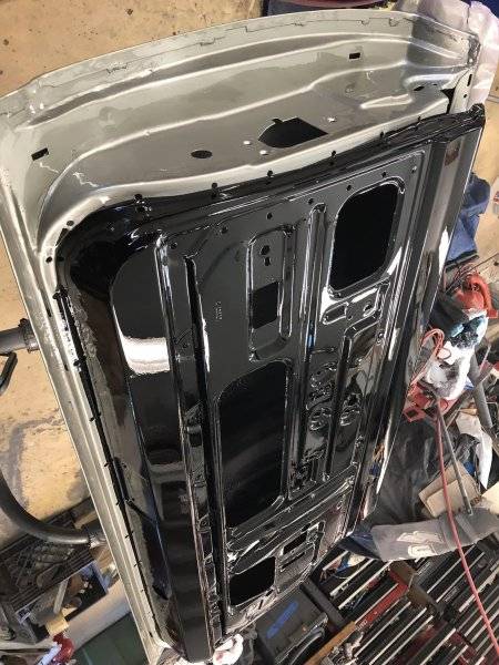

I just did this refinish on my 67 Coronet convertible. For the doors I sanded the original finish and sealed it with a PPG epoxy primer. Then I top coated with black PPG type DCC urethane with hardener. Used the same formula on the rear housings. The lower parts of the rear I used a satin black.
DCC is their Concept paint which is quite expensive, but I had some leftover from a previous project.

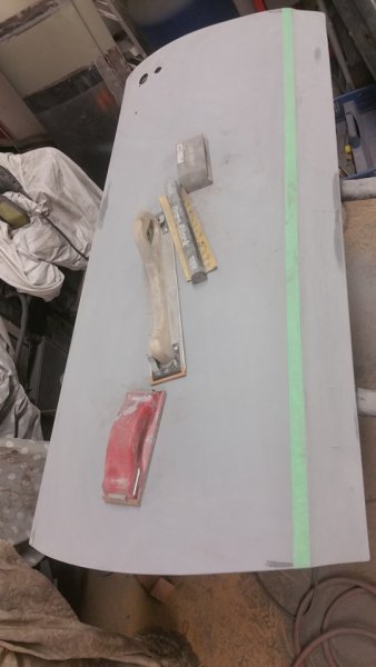

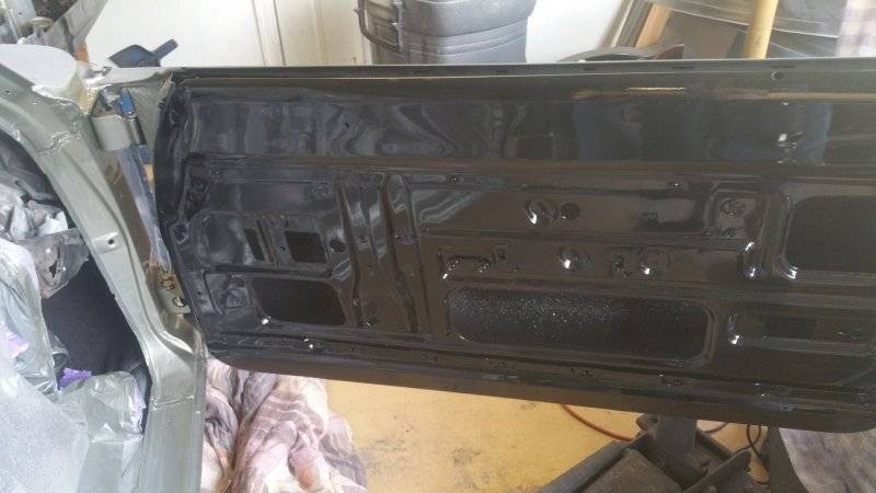

Did the inside of mine with SPI products (epoxy/black basecoat/universal clear).

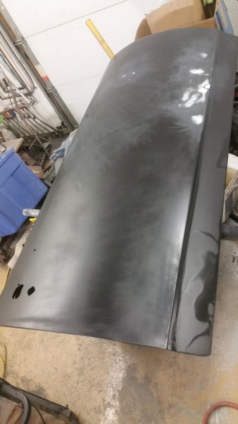

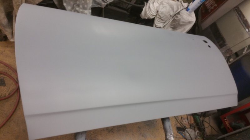

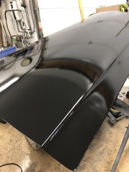

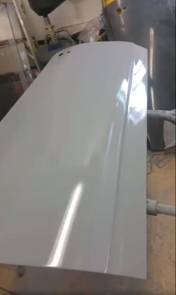

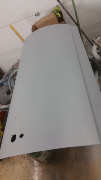

Last two attachments to illustrate....
Strongly recommend real, modern automotive grade products, all 2k with catalyst/hardener, from primer to clear.
If you have no choice but to use rattle cans, try the spraymax products that have a hardener built in, that you puncture at the bottom of the can.
Same process as everywhere else, epoxy, block, mud (barely any needed), epoxy, surfacer, block again and maybe block a few more times.
