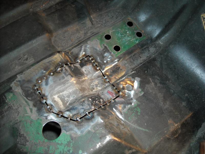

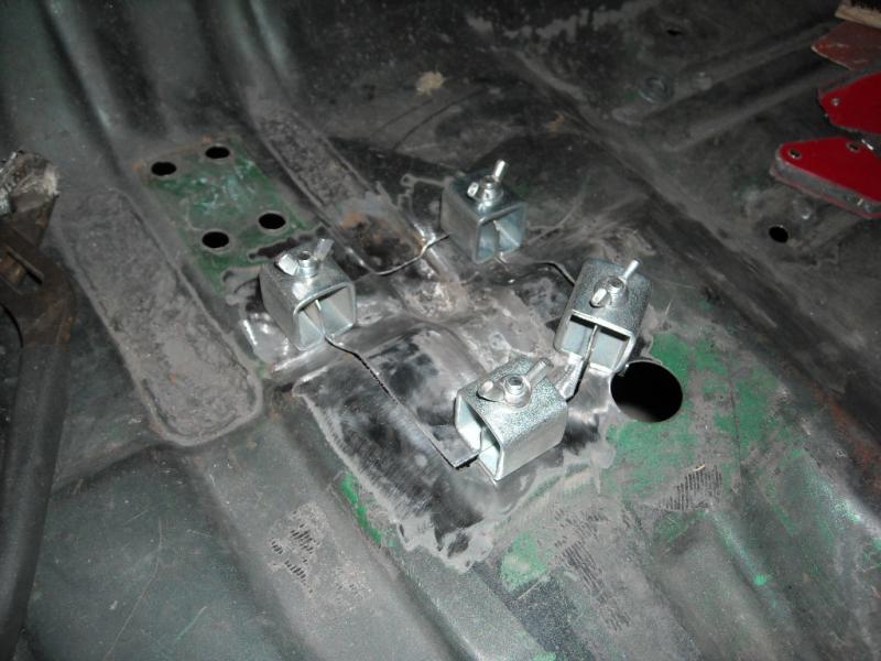

I bought some butt welding clamps. Eastwood carries them. They hold 2 pieces of metal together for butt welding & they leave a small gap between for the weld.Its like having an extra couple of hands. Only thing aggravating is to get the 1st couple attatched. I think they come in packs of 4 & 8.
