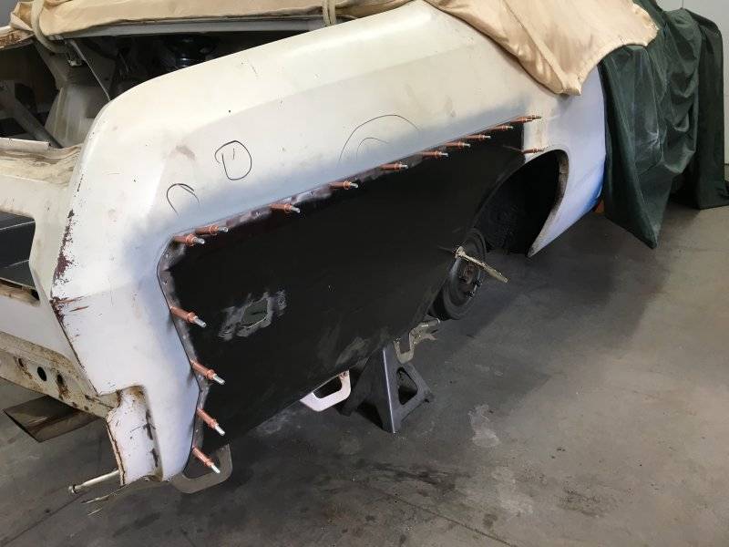

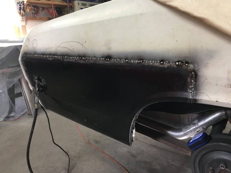

22ga is a little easier to form than 18ga, but MUCH harder to weld without warping or burning thru... at least for me.

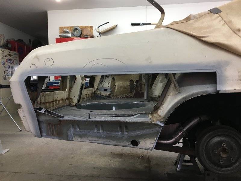

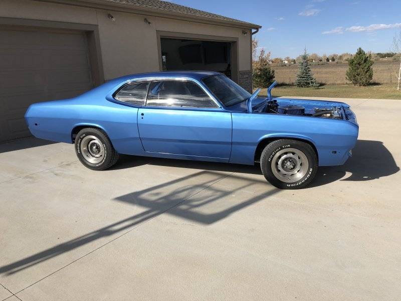

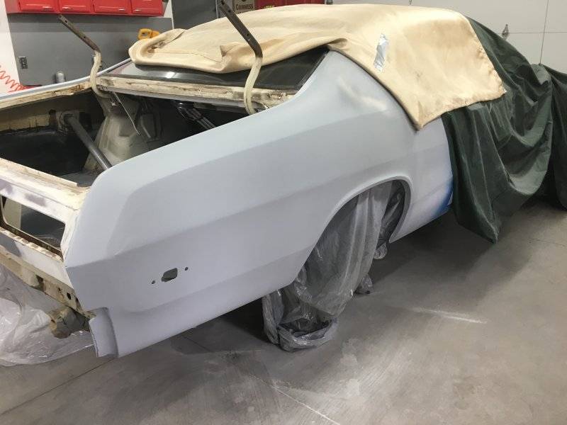

I have been cursed with knowing how to do it unfortunately. My son's 72 Duster. Not perfect by any means but good enough for a 16 year old. My skills are a bit rusty. I hate blocking too.
