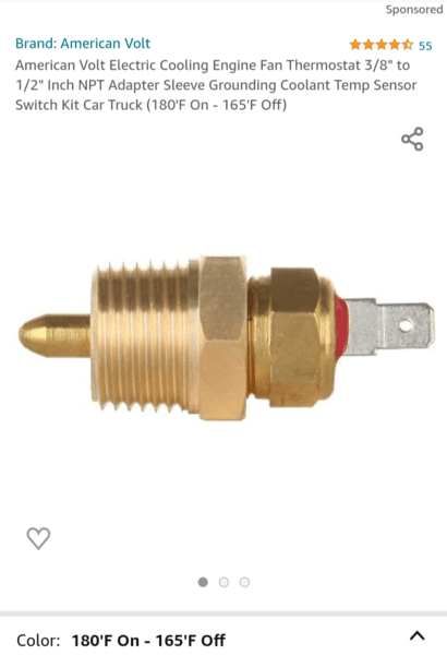

I use this it connects the ground wire on the fans at 185 and disconnects at 165.

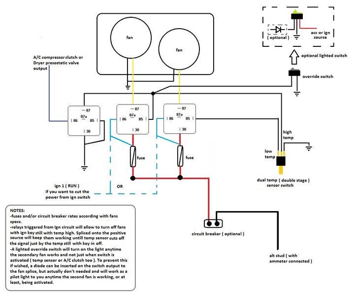

you can use two thermal switches one for each fan, or use a dual range thermal switch... wired like this:
I made this diagram with switches using ground to trigger them. Some switches don't get the chassis ground source but get a prong for it

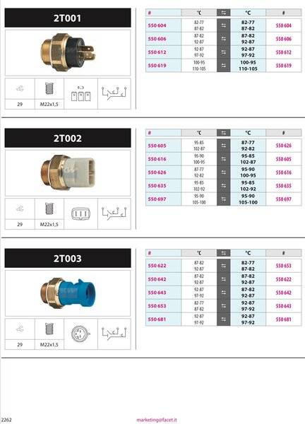

diff temp ranges... match your needs.
sure will need thread adaptors to use one of these

I can't seem to find those sensors . I am trying to find the 2t001 - 550 604.... but those numbers don't seem to bring up what I want.
I keep getting referenced to a holley part for 550 604 number .
any idea on year or model that would take those sensors??
I think they are used on European cars... hence the metric thread. The website I found those was from Italy as far I recall.
Anyway those are just a suggestion. Pretty sure there must be more options around.
