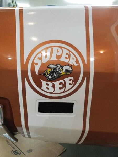

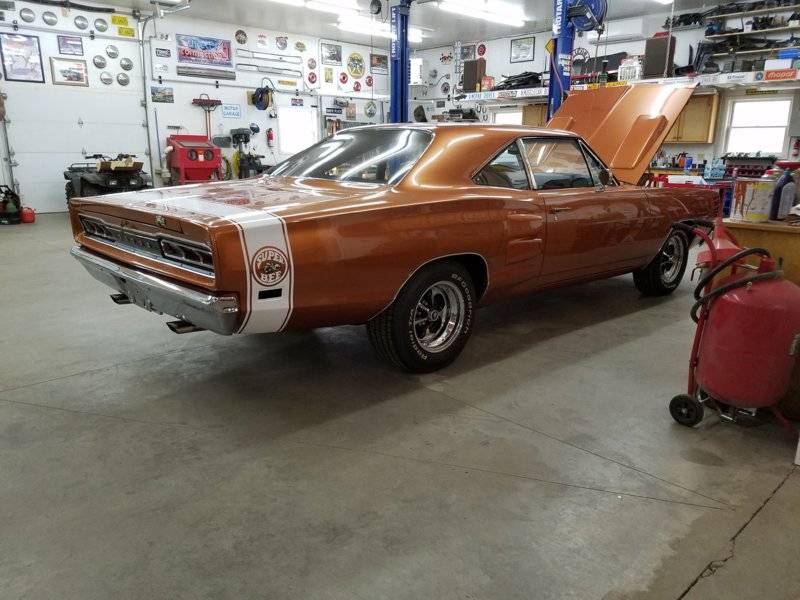

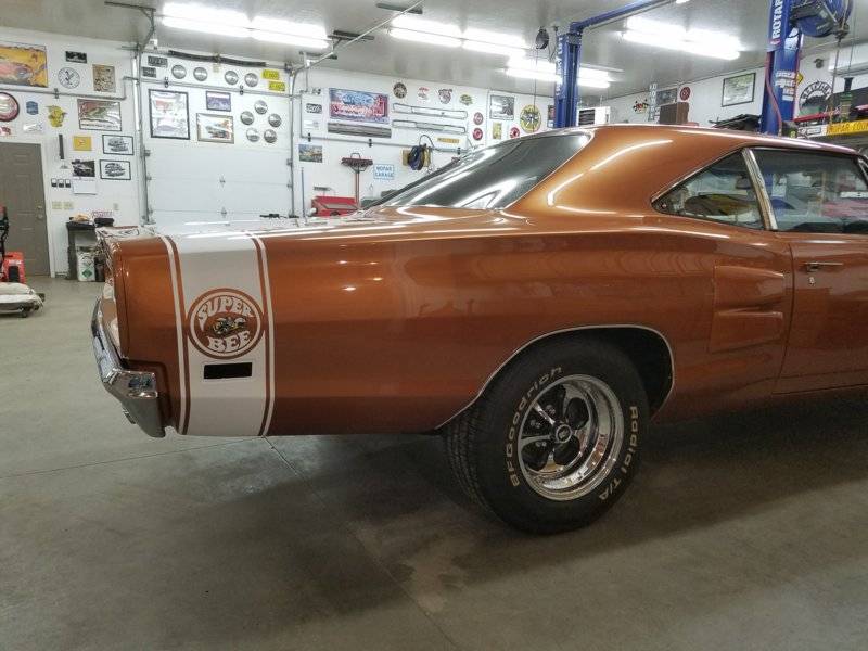

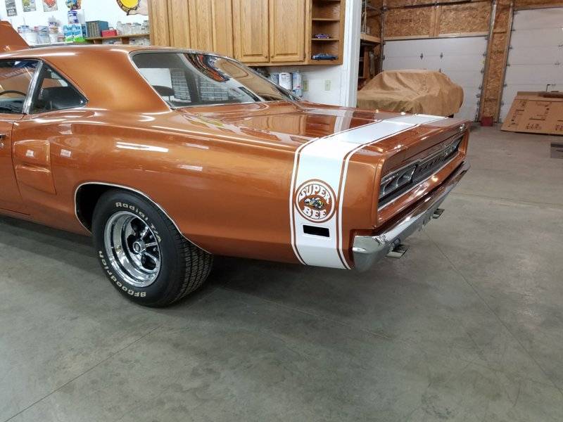

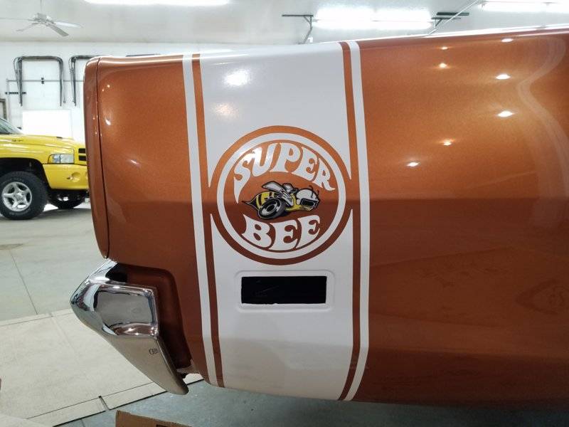

Posting this up here in addition to my restoration thread just so others can be informed of the quality issues as well as the very poor customer service from Phoenix Graphics.

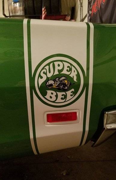

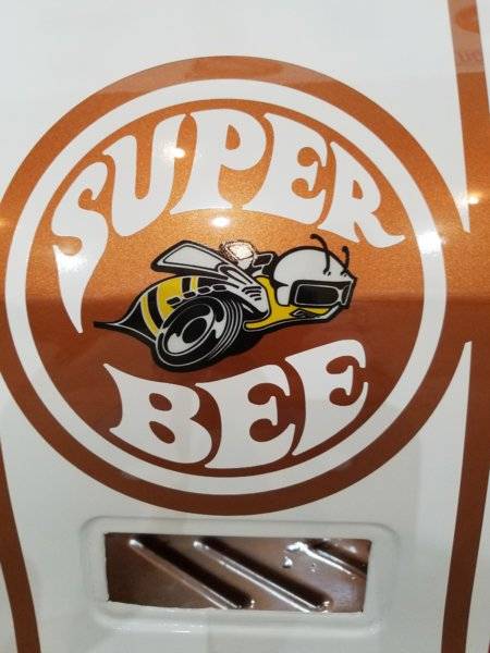

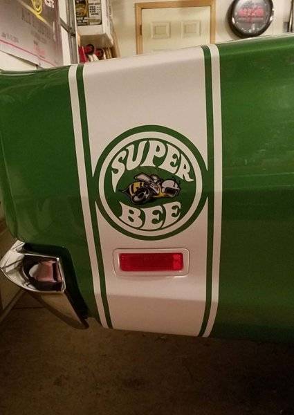

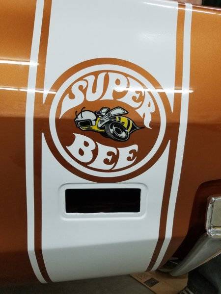

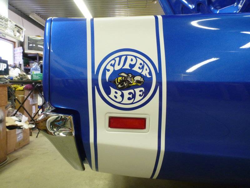

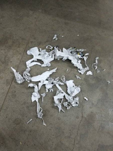

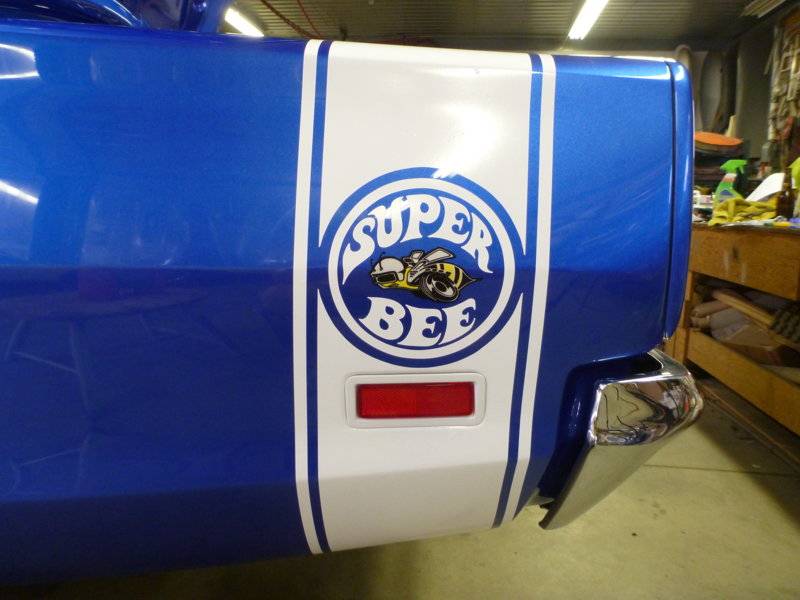

I decided to save the $62 and try Phoenix for the first time. Turned out to be a big mistake. Got the stripe in a week and called up my decal guy to come put it on. We did the drivers side first and noticed a couple of issues after peeling off the backing. The correct way to lay these out is to have the brim of the helmet on the body line and that should leave 1/4" or so of decal between the circle and the reflector opening. #1 was that the the Bee in the circle was not quite level and #2 was that the circle was getting down into the reflector. At that point I decided to live with it and we moved to the other side. Passenger side was way worse. We finished the install and stood back to look at it. Took some pics and came on here to get feedback and photos from a couple of other members. In the pics my car is the T5 one. The blue and green cars are members cars that used a Performance Car Graphics stripe. You can clearly see how the Phoenix one is clocked wrong. I went out and spent 1.5 hours ripping the stripe off.
I left 2 voices messages and 1 email with Phoenix Graphics just asking if someone could contact me because I had some questions about a rump stripe I purchased from them. This was over a period of 3 days. No response. On the fourth day I ran across another phone # for them that wasn't listed on their site. Called that at like 7:00 pm expecting to leave another message. Was surprised when somebody answered the phone. The guy was nice, said they sell piles of those stripes and have never had anybody raising a concern with them. He asked me to send pics. I did, along with pictures of Wayne and Darrins cars showing how the Bee logo and lettering should set level as well as the correct spacing between the circle and the reflector opening. He said he would look at them right away the next morning. Never did hear back from him. Sent a follow up email asking if he wanted the stripe back that I tore off the car. Still no response. So the next morning I contacted my credit card company to file a dispute. They reversed the charges and if PG doesn't respond to Chase within the next 2 billing cycles it will be over and I will only be out what I paid to have the stripe installed.
So long story short, I really don't care if Phoenix Graphics is a sponsor here or not. I am stating the facts that they make an inferior rump stripe for 69 Bee's. Also their customer service flat out sucks. A guy shouldn't have to go through a credit card company to get a problem rectified, and I will still be out money. My guy also said that the stripe from Phoenix was either a poorer quality vinyl because it was much rougher after installed than PCG, or it was sitting on a shelf for awhile. He also had a lot harder time getting the backing off the PG stripe which would point to sitting on a shelf to long.

Joel. Looks like Phoenix Graphics sold you an inferior stripe for sure. I hope they refund your money. They certainly should if they value feedback and the quality of their products. Can't wait to see your Bee in person. It looks perfect!
