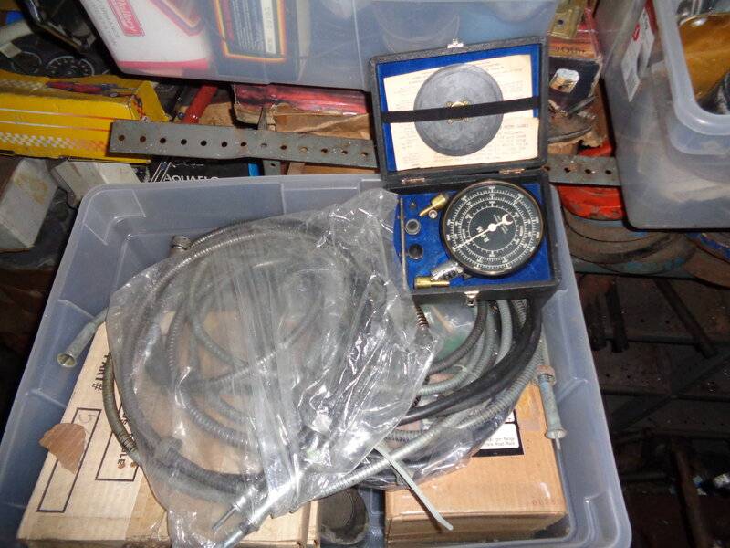

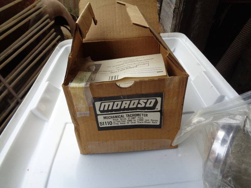

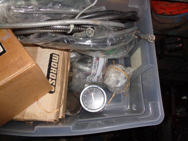

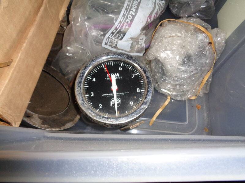

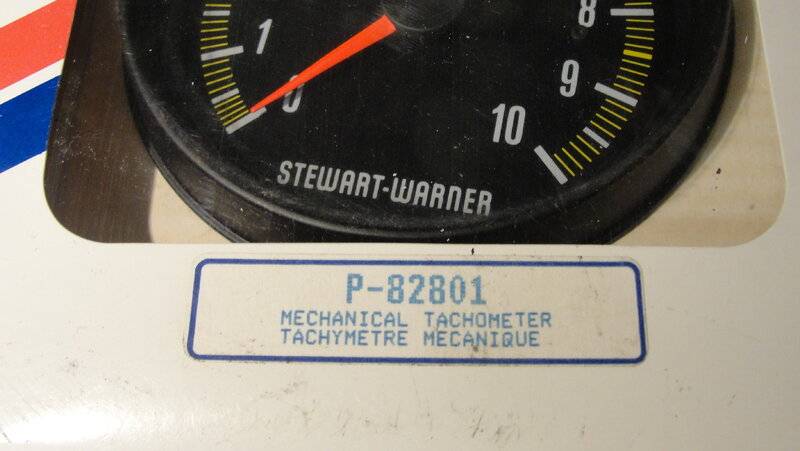

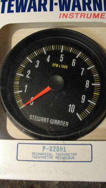

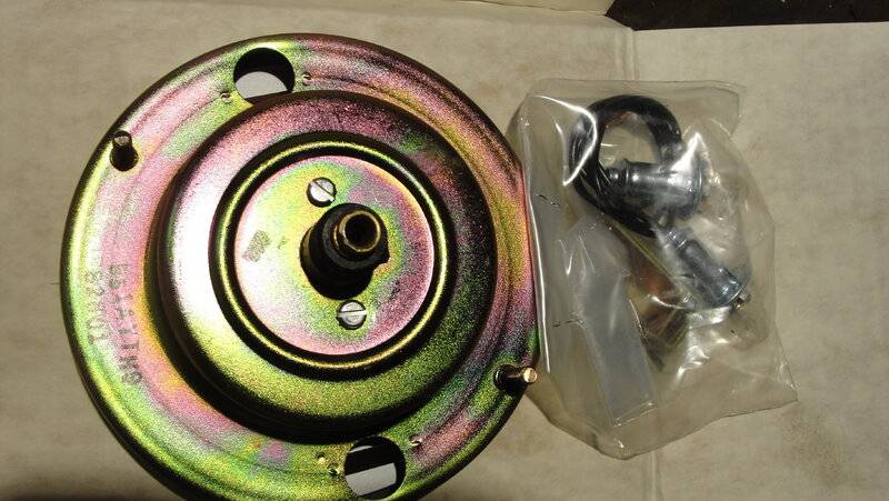

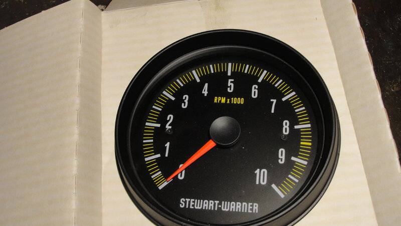

I have some cables and also NOS SW 5" panel mount tachs if needed.
None but never know what I fall across.

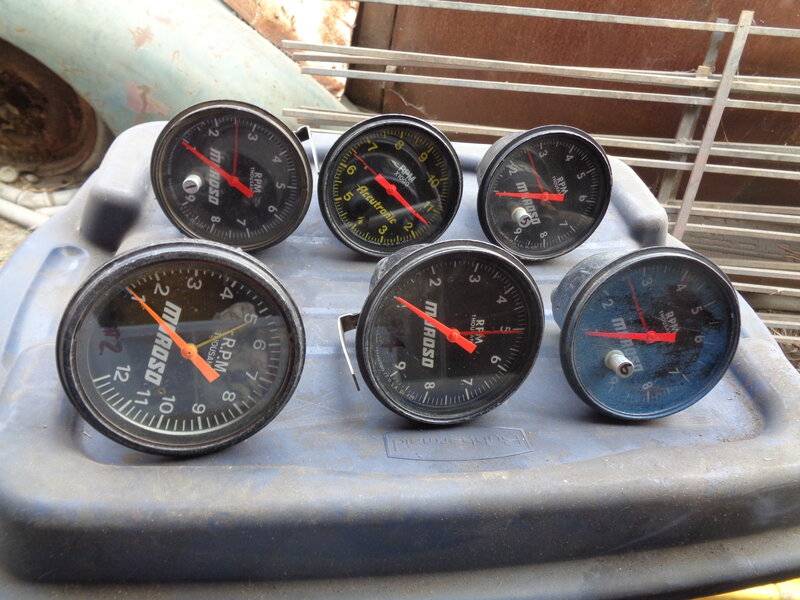

Mechanical tachs! Calling @POMONAMISSEL .
Frustration, you are aware that stewart warner, and jones-motrola/moroso use different tang styles and cables, right?
Ive got a couple moroso, but im using an old mopar electronic cast iron tach drive distributor, and i dont really want to get rid of them. Pomona missel has an absolutely amazing collection of jones tachs (his are marketed under numerous names, all made by jones-motrola [not motorola]).
yes jones was the one , everyone tagged on with the jones , yes i know of several different drive styles , but one of the most common was the chrysler tag drive end . and there are adapters to accommodate the different ends , if you can find them these days .
Awesome Tachs. I have to get some pics of the cables I have.
