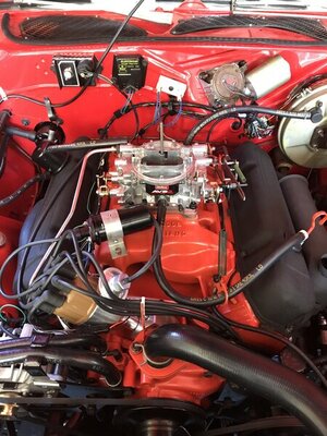

I guess that all means "the carb you have can definitely be causing the slight surging issue you're having"?
I don't either, actually - just THIS one. It was inherited with the engine I bought and I'veAnd I have nothing against Eddy Carbs
Hey HH, thanks for checking in.Sounds like the Distributor/ignition is ok if he checked the side play in it (side to side of the shaft in the housing. Kind of sounds Carb to n=me. Yes I run a 1411 and it can be lean, opened up the jets a bit on mine.
Find some one that has a scope to definitely confirm the ignition is fine.
