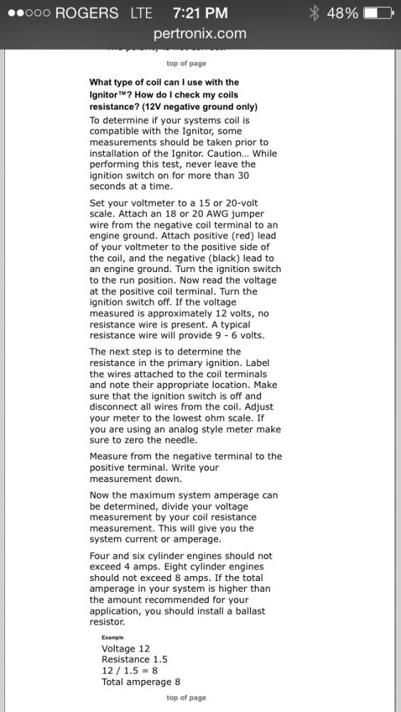

I found this on the pertronix site. Should i use a factory coil to do the test before i buy the pertronix one?
