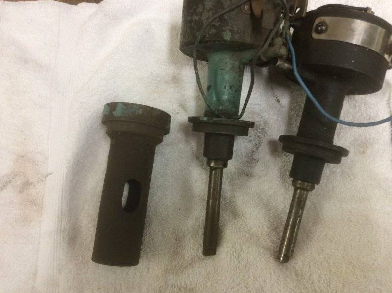

Didn't Pertronicx make good on the shaft, maybe I missed it? Did the tip break? I don't think the drive gear pushes a lot on dist shaft. Have marine setup, reverse rotation ehgine and it has a piece that goes in dist hole that keeps dist from pushing on dist shaft. Piece on left, note longer shaft middle.
Didn't Pertronicx make good on the shaft, maybe I missed it? Did the tip break? I don't think the drive gear pushes a lot on dist shaft. Have marine setup, reverse rotation ehgine and it has a piece that goes in dist hole that keeps dist from pushing on dist shaft. Piece on left, note longer shaft middle.View attachment 1480398
On the first one that broke yes, we are still talking about the second one that broke which I just sent back to them yesterday. I do not want another distributor so I was thinking their electronic distributor conversion kit but that won't work either. They claim it will work but after I gave them the number off of mine they said it wouldn't work. So where do we go from here I'm not sure
