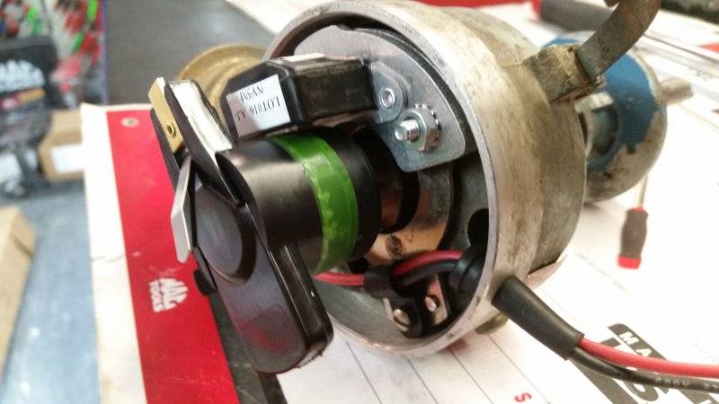

Look at the differences in these rotors. White is stock, black is pertronix. How are you going to swap the green ring to a stock rotor? It is too small and too much gap to the pickup. This is what I am looking at when I type my post. And toolman Mike has the same setup.
Now maybe they changed the rotor as the system evolved.
I'm not sure what the issue is. You can pull the hall effect ring from the black rotor and put in on the white rotor. Or use the black rotor/hall effect.

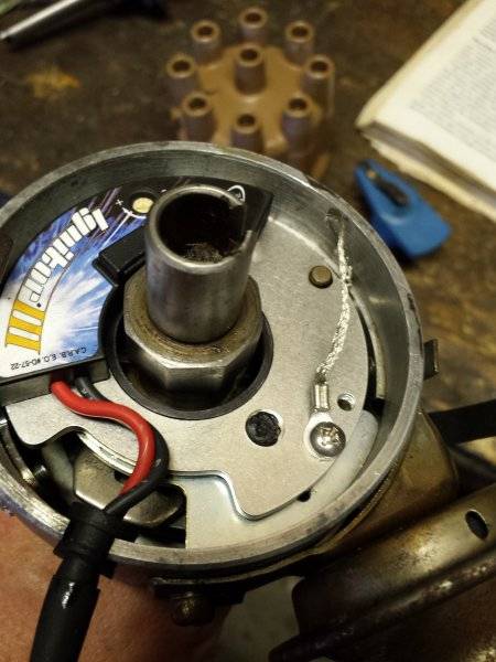

That is standard in the Pertronix 2. If he buys the pertronix 3, there is no collar. Spark is timed off the lobes on the distributor.
I am using the Pertronix 2 in my 62 Belvedere, with solid state ignition box and Flamethrower coil. Retrofit on my points distributor.. Runs perfect. It is about 8 years old.
I also have a pertronix 3 in my GTX. No hall effect, multi spark, rev limiter. Also being used with solid state ignition and Flamethrower coil. Retrofit on my old distributor. Runs perfect.
