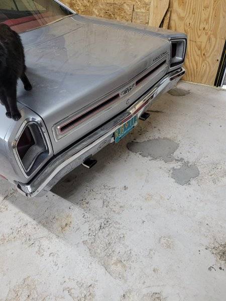

Modified and welded. I would not buy these again.
