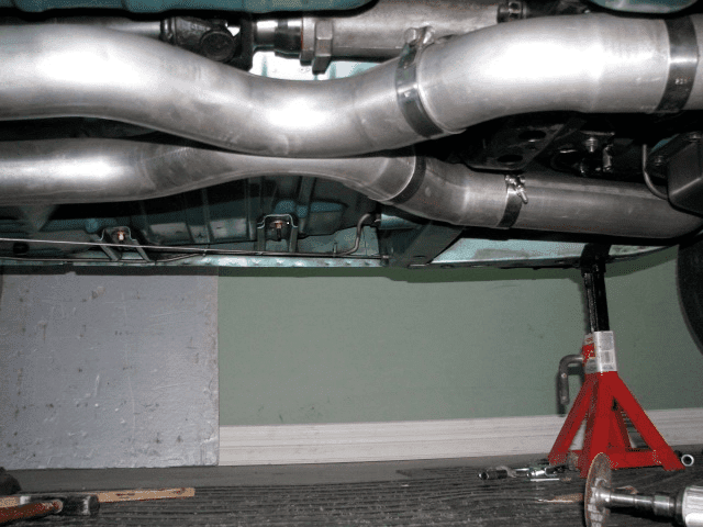

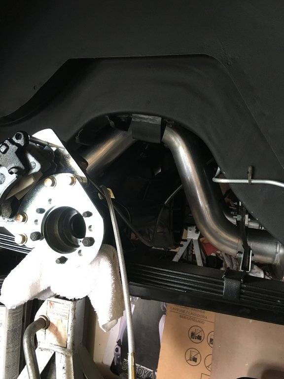

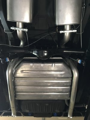

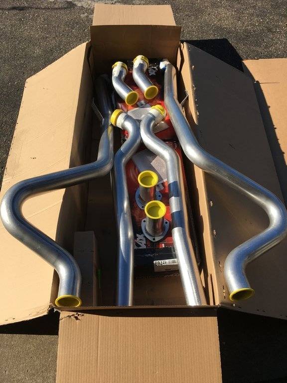

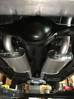

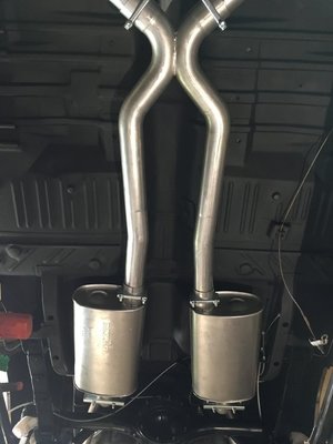

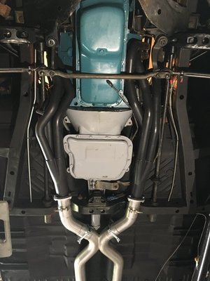

Unpacking my exhaust, looks very nice.
Here's the pics of install.
Went together very nicely.
I'm very happy with how it turned out.
Do they supply mufflers? If so, what brand do they choose?
Looks great. How did the 3 inch tailpipes fit between gas tank and rear frame rails? Tight?
On the hangers do you have to have the ubolts pointed down? I prefer the ubolts pointed up if there is clearance. Just a cleaner look and they dont "hook" you when working underneath.
Same thing I was wondering ? my 67 net has 2 1/2" flow master tail pipes and its real tight along the tank ,springs and rails.
For tti to get a 3" through there , that's some rocket lab work now.
Hats off to them.
TTI 3'' with Dynomax turbo the way to go...
