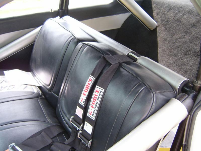

This is on my old car but it passed tech in 4 different states at 7 different tracks.

thanks, it that just wrapped aournd the bar? no brackets or anything?
That's it. Wrapped and secured with the slip connector. Never had a problem. It ran at many NHRA points meets as well.
