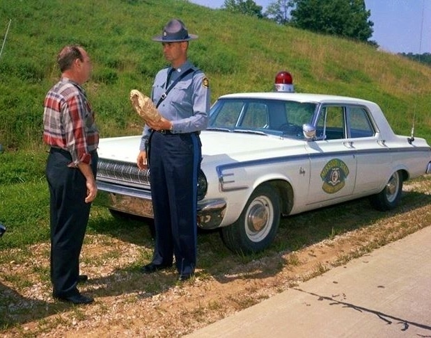

Here's one with a cop.
Kurt those are 4-link suspensions. IRS is independent shafts hanging from the center section, like this http://www.heidts.com/part/heidts-superide-irs/ not straight tubes/axles like those in the 4-links.
Ah yes - not thinking straight tonight.
