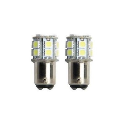

I bought these at Walmart for $15.00/pair to experiment with. They were plug and play in my 68 RR. They are just a little bit brighter than the incandescent. Turn signal acts normally and does not hyper-flash. They are a little different shade of red through the lenses because LEDs have whiter light.
I wish there were a little more contrast between tail and brake, but I think they will do. I am going to use them for a while because the reaction is instant; both sides light at the same time when you push the brake pedal. With incandescent and the ancient wiring in my car, one side would light up a moment after the other, and the hazard lights would be out of phase.

One thing I learned is that when using LEDs, use the color that matches your lense. For red brake lense, use red LED.

If my original 1157 taillight bulbs under the red lenses of my 70 Road Runner are white, shouldn't I go with white LEDs?
I tried it both ways. On mine it looks orange with the white ones. I also read that somewhere; something about the wavelength with LEDs means you should use red with red lenses.

Does anyone know why using the led in my right rear lense would make me lose my turn signals? I can put the bulb back and they work fine with an led on left. Puzzling

I decided the connection posts are not the same. 2 led and I get two solid lights with either signal on. 1 led and 1 bulb I get 2 flashing lights on the led side and a correct blinker on bulb side. 2 bulbs every thing works as it should.
You may need an electronic flasher the old type flashers require a certain amount of resistance to click on and off once you start putting LED bulbs you can drop below that and they won't work anymore.
And you should always use the same color LED as the lens you get better color and more light that way.
I have read the same from SuperbrightLed to always use the corresponding LED light color to the lens you are using it with (red with red, amber with amber)

the 1157 is a two element bulb and the pilot 1157 led is single element meaning a converter is required in the wiring unless there is a two element led out there? Not sure.
