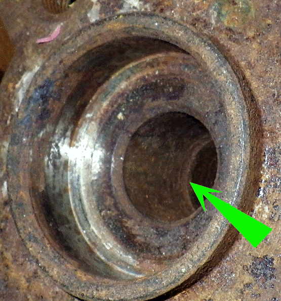

how far in should pilot bushing be installed into crankshaft for a 4 speed trans ??
Flush with the flange. But it will take ten more replies to confirm this.
Here’s the first one not flush with the flange but flush with recess in the crank
I believe Beekeeper is right,been a while since Ive put 1 in. Put it the freezer before you install it.
